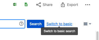

You can switch to the Basic Search option:

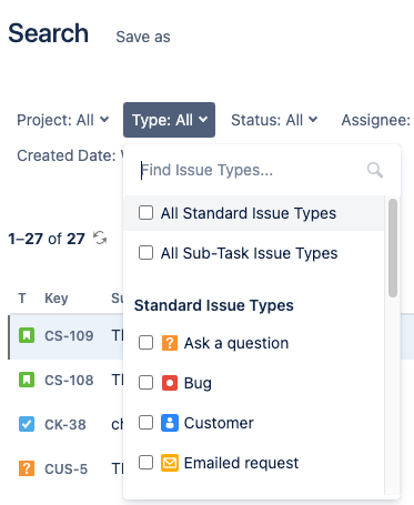

And then use the options available to indicate you want to search for issues of specified types by check marking the types you want to include:
