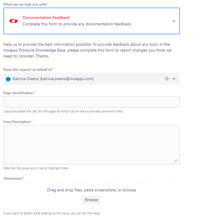

I set up a Documentation Feedback Form to be used by customers based on the Task Request Type in JSM. Out-of-the-box it provided a drop-down of usernames and email addresses. I can't remove it. In our multi-customer scenario, this will be a GDPR breach.
Is there a workaround to restrict the users that the current user can see in this list? It is a handy field to have, but we cannot use it if all users can see each other's details.
It isn't visible in the Request Form Editor so I can't delete it.

docfeedbackform.pngHi Angelia,
This has been resolved as we discovered yesterday that customer users don't see it, only internal ones.
However, when you're setting up the form, the inclusion of this field isn't even mentioned: would be good if it was there with explanation so people knew about it and when it is visible. I had to waste time chasing the issue up.
I've attached the custom form. It's based on the Task Request Type. See Raise this Request on behalf of...

Thank you for sharing, @Katrina Owens.
When an agent accesses the request form in the portal, they will be able to see this field because they can create tickets on behalf of the customer and it won't show only customers, but internal users as well.
This is important because, if they create a ticket, customers will receive the notification informing them about that and agents won't need to change the reporter after the ticket is created.
This field indeed can't be removed, but it's something that only administrators and agents can view.
The field is also visible internally when using the "Create" button:
