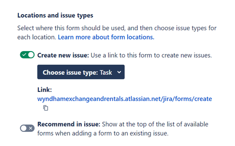

Inside the form when editing, go to the Settings tab. Click on the option for Create new issue.

Yes, I will be interested to know what you find out. When I test it here, it opens the form for me to fill out when I click the Create button.

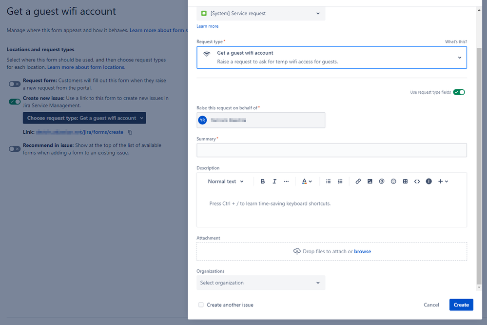

I tried again this morning and I still don't see the form. Also after clicking on the create button nothing happens. I need to manually add the form afterwards.
Am I missing anything? This is what I see currently when opening a new request:

G'day Yannick - is that not your form?
Yannick R_
February 7, 2023
Unfortunately not. The form should look like in the picture (Build view)jira2.png

Can you share a screenshot of the form as it appears in the portal when a user goes to create a new request?
Yannick R_
February 7, 2023
Hi John, I think i found the "issue".
I tried to create a ticket out of Jira itself which resulted in the form not being displayed. When opening it via the portal, like a user would do it, I found the requests with my custom forms. It is working now :) Thanks a lot for your help during that phase!
