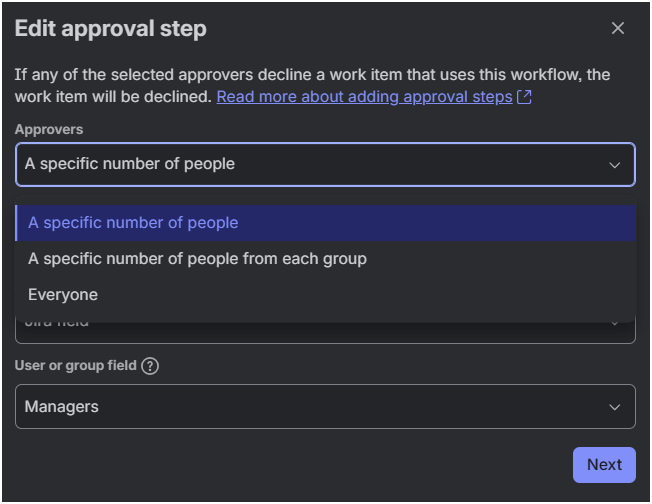

As of now, there is limited flexibility when it comes to how many people are required to approve a step in a workflow (see below). What happens if the group of approvers increases or decreases frequently? Say I have a group of 8 people and I need at least 5 (50% + 1) of them to approve a step. But, one day your boss decides that 4 more people from management need to be part of the decision process. So, the group is now 12. However, that means that YOU are required to go update the approval step to reflect 7 people now that need to approve (50% + 1), but he neglected to mention that to you. I do not believe there is currently a proper fix for this, so the question is:
Who has dealt with this and what is the cleanest, most effective & concise way someone has remedied this problem?
The more I've thought about this, the more paths I go down that make this seem like it could wind up quite messy in the end. Sure, automation rules could be leveraged, and custom fields could be created to count approvers and such, but I'd appreciate the community's thoughts on the matter. Hopefully, I've explained my goal well enough, but let me know what details I may have left out, thx!Screenshot 2026-08-25 154630.png

The percentage route answers the part you are calling hard coded.
A specific number of people from each group pins a count, and that gives you nothing here. The setting underneath takes a proportion. A proportion does not care how big the group is: on 51, eight approvers wants five and twelve wants seven, and nobody touches the config when the group moves. Same control I described earlier, set through the workflow REST endpoint, since the dropdown will not offer you 51.
So you likely do not need a workflow per CAB. Marc's Assets route and this one fit together. Let the Service drive an automation that sets the approver group, then let the percentage derive the number from whoever lands in it. One workflow, many CABs, no issue type sprawl.

The dropdown in your screenshot offers a specific number, a specific number per group, or everyone. None of those is a proportion. The setting underneath takes one though. That control writes a workflow property whose mode can be a percentage, so put it on 51 and the step works the number out from whoever is in the approver field. 8 approvers wants 5, 12 wants 7, and the config stops needing you.
The UI won't hand you 51. Everyone is percentage mode pinned at 100 and that is the only percentage it offers. For any other value you read the workflow with POST /rest/api/3/workflows, change conditionType to percent and conditionValue to 51 on that status, then POST the whole thing back to /rest/api/3/workflows/update. Partial bodies get a 400, so send every status and transition along with the current version number.
I ran it on a test site before writing this, with a user picker holding the approvers. Two approvers at 40% cleared on one approval, ceil(0.8) being 1. The same two at 51% didn't, ceil(1.02) being 2. One approver at 51% cleared.
Now the price. Atlassian's KB on these properties says setting them by hand is not recommended and may lead to workflow issues, and the workflow validator answers APPROVAL_MISCONFIGURED for any percentage but 100, so you own this one. The decrease half of your question also has teeth, because a proportional threshold recomputes when the list changes. I pulled one of two approvers off a request sitting on a single approval and it went straight through to Waiting for support. On your numbers, taking four people out of a group of 12 can approve something that was still waiting.
On the counting custom field, the step can't read one. conditionValue is a literal and nothing in that config lets the count come from a field. The supported way to stop the hand-editing is the middle option in your dropdown, which holds at say 2 per group however big the group gets, assuming Managers is a group picker. I only ran the percentage against a user picker though, and Atlassian's own property table pairs percent with everyone and the per-group option with a multi-group picker, so if Managers holds groups rather than people, try it on a test project first.
Company-managed. Team-managed approvals sit on the request type and I haven't tried this there.
