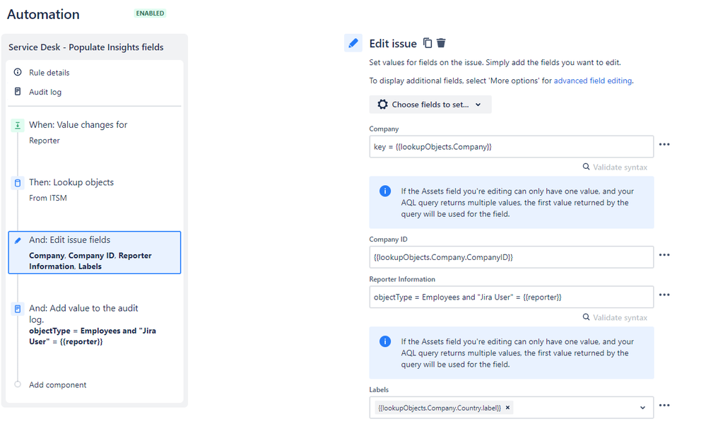

Your automation can look something like this
This should give you a ballpark idea of what to do.

The details above surely put me on the right path.  However, my path was blocked slightly as I tried to use the Organization Name as the field to link the ticket to the asset Objects.
I found out in the last 24 hours (by accident, as I was looking for an answer to another issue and stumbled across this "feature"), that the Organization Name does not work with Asset lookups in automations.
So to resolve this, I created an Automation to update a new custom field (ORG_Name) with the Organization Name info, and then I used this new custom field to link the ticket to the asset objects and was able to do lookups and fill out custom fields for all the attributes needed in the ticket.
Once again thanks for the nudge in the right direction.
