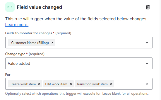

Pauline Hennau
February 17, 2026
Hello,
this question is quite old but if the answer future user who encounter this bug :
I added all the operations instead of leaving the field blank "all operations" like this and it triggers perfectly at creation
Michał
February 17, 2026
thanks :-)
Morgan HB
September 1, 2026
This worked for me in JSM DC. Thank you. Prevented an overly complicated fix. You're my hero today.
For background: "Create issue" was working when the issue was created via portal or create console, but was not working when Automation created the issue. (The "Allow Rule" box was also checked.)

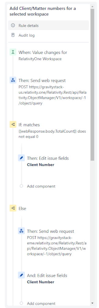

Can you please share a screenshot of the rule?  It's a good sign that it is at least triggering.
Kelly Wehbi
February 13, 2023
@Mark Segall Had to share a GIF cause it's pretty long. Can also confirm the POST requests are working just fine.
Mark Segall
February 13, 2023
Thanks for sharing the screenshot. The fact that the rule is triggering means that you would likely have the same result on issue create.  I would recommend adding a log action just after the send web request action so you can see what's coming back in the web response.
Kelly Wehbi
February 13, 2023
It works fine on Edit issue. If we change the value in the field after the ticket is created, everything works as expected. This is only failing to properly update when an issue is created.
Mark Segall
February 13, 2023
I understand the situation, but according to your previous response, the issue is triggering on issue create, but quickly exiting due to not meeting a condition.  So, it would be worth adding a log entry after the send web request to see what is coming back in that instance where an issue is created vs what comes back when the issue is edited.
