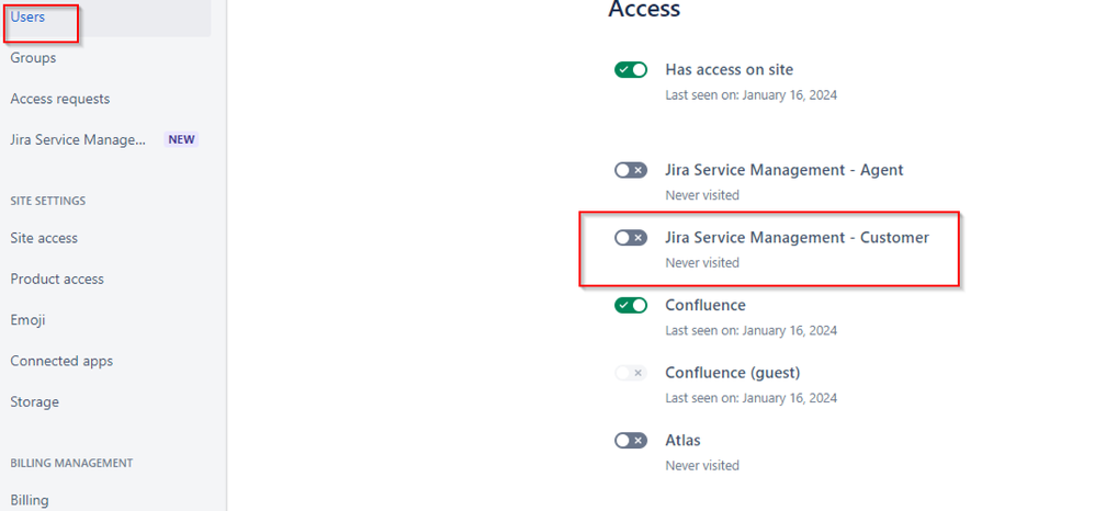

I finally found the solution to this.
It was indeed related to what you meant with the permissions and login. Certain users had been created without all the permissions needed to create an issue.
To solve the problem, one needed to go to the Atlassian admin site (https://admin.atlassian.com), select the concerned user and activate the customer button (see screenshot below).
My problem: I had no access to this section because I was not registered as a site admin. It's now the case and can do those changes myself :)
