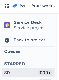

Hi @Frederic Chartrand
I want to transfer the "service desk" project from the live environment to the test environment.
We won't have problems in the live environment while copying, right?

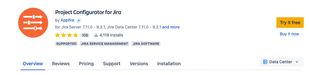

Project Configurator for Jira is a great app to do so. I'd recommend this one.

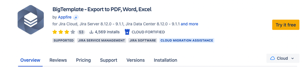

@Frederic Chartrand
Which option should it be?
Frederic Chartrand
October 25, 2022
Project Configurator is not available in cloud.
I'd use this one from Appfire.
