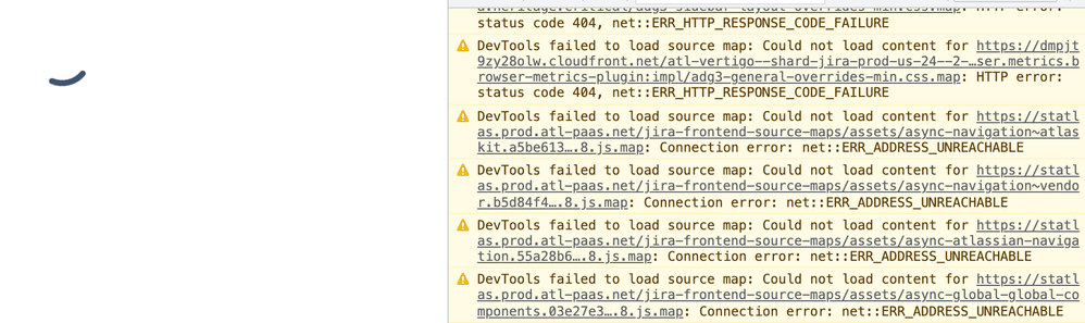

Hello,
When I try to change the customer notifications and setup e-mail to receive the incident, the screen just keep in looping and nothing happens.
Please see the attachment.
Thiago

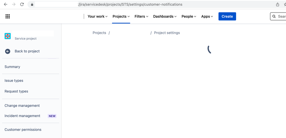

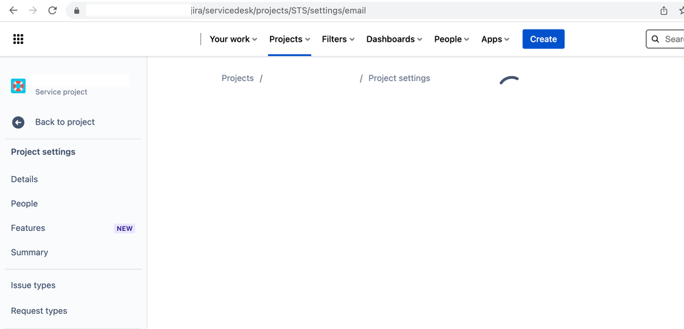

Hello @Jack Brickey , sure!
I am trying to change the default notifications message and setup the inbound email to receive the incident from my customers.
Please, see the print (I am using the cloud version).
Captura de Tela 2021-12-22 às 17.04.04.pngCaptura de Tela 2021-12-22 às 17.04.16.png

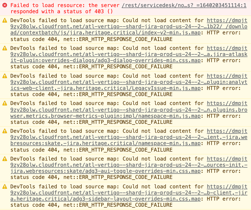

Also, when I switch to debug mode, I can see the errors below:
