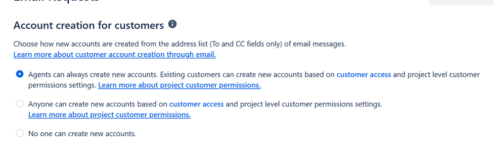

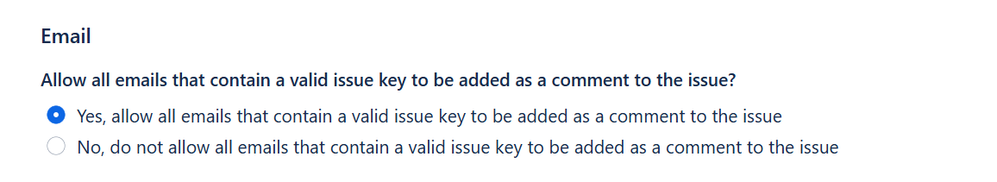

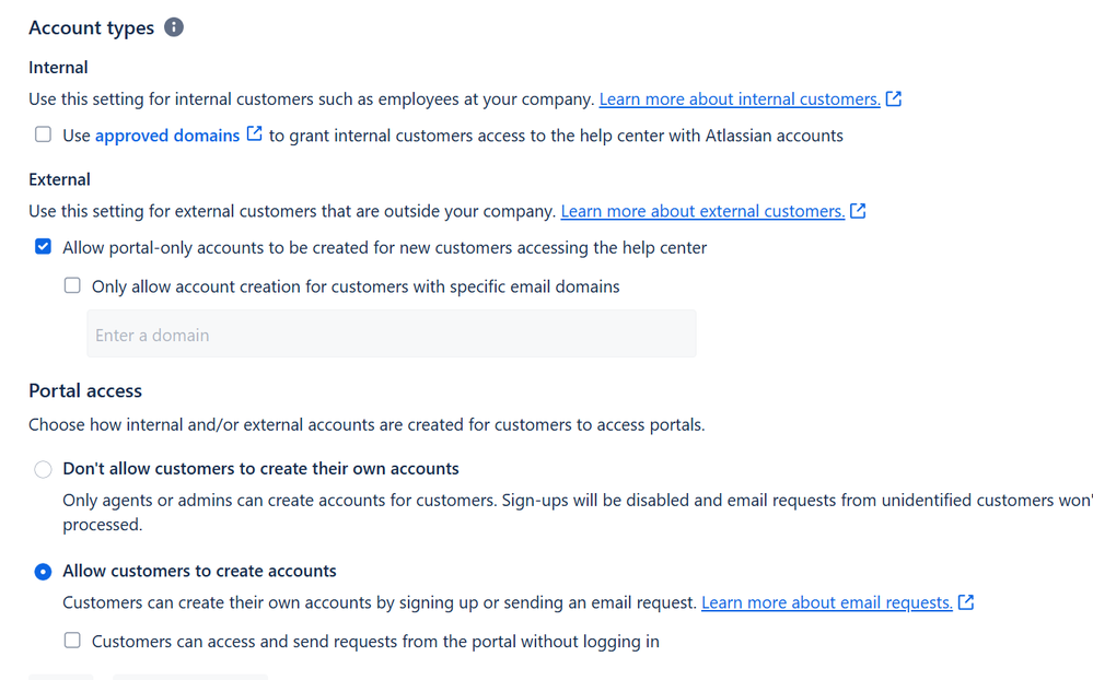

Below are some screenshots of our email and access settings. None of these settings were changed recently.
Have there been updates to Jira's DMARC or email settings recently? Does anyone know what could be causing this issue? Thanks
