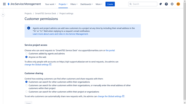

Can you share an mage of Customer Permissions under project settings? You don’t need to define the customer ahead of time if your project is public. Can you please check on my #2 request above, does the customer in question here actually have issues already reported?
Rajesh Mankad
July 26, 2021
Yes The customer did report an issue. As I mentioned in my previous communication, we can see the issue from support@smartites,com web mail.

Ok so you have it set up as a public project so that anyone can send in a request. So I can’t think of any reason why an issue would not have been created. However to be sure about this I would search using JQL. Go into the advanced search area by clicking in the search bar at the top of the menu and selecting advanced search. Once there use the following JQL to see if any issues are found this specific customer.
