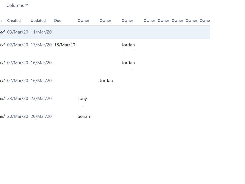

Susan, I have deleted the Owner1 and Owner2 fields which were not global.  I am down to the global Owner field.  Question I have.  Look at the picture below.  It shows an Owner field for each project.  Is that how a global custom field works - there is a column for each owner?  I was hoping that the Owner for each project was in the same field.  It makes it hard to do reporting across projects if the Owner custom field is in different columns.  Any thoughts?

Brian Beard
March 24, 2020
I have found that the Owner in one project is in one of the columns and the Owner in a different project is in a different column.  only one name was selected for each task on the project.
Susan Hauth _Jira Queen_
March 24, 2020
Hi,
So when you export a custom field that is multi-select you will get that multiple column view as Jira is trying to show you all the values that were selected per issue.
Wondering why you aren't using user picker for owner if it's actually an individual(s).
Cheers,
Susan

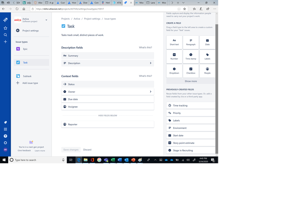

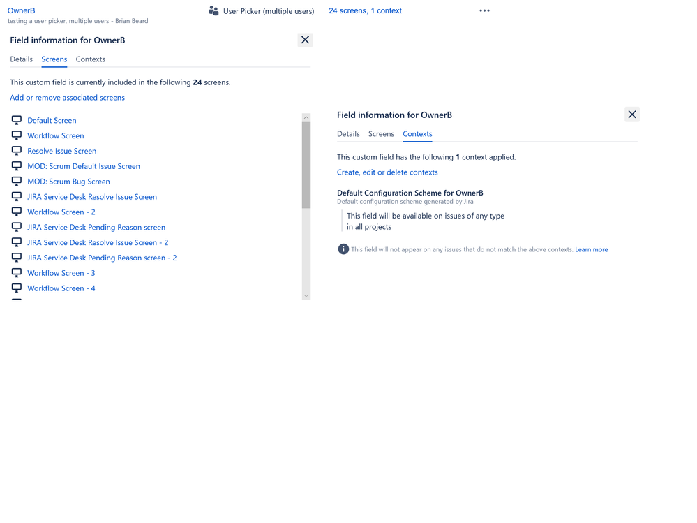

I created a new global custom field named OwnerB.  I then added it to all of the available screens.  When I go into a project and try to add the new field to the Task, the new field is not listed.  I have also noticed that I don't have the "Search Fields" that another person has right above the "Time Tracking".  I am an Administrator in Jira and I also gave myself Administrator access to this project.  Do you know why I wouldn't have this option and be able to select my new field?Jira2.png
March 24, 2020
Hi Brian,
If you made it global and added to all screens it should just be there.  Did you try to create an issue to see if it is there?
Susan

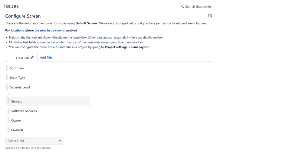

Can you paste the field configuration in here, as well as the screen configuration and the project configuration.
Brian Beard
March 24, 2020
i do see the OwnerB field in the Screen configuration when I look at the layout...just can't add it and I never see it on a screen.

So I see OwnerB on the "default screen". But It's not apparent to me that Astiva is using the default screen scheme?  Because you don't see OwnerB in the Task screen in project Astiva.  I'm not a huge cloud user,
Is Astiva a next-gen project?  That might be a factor and I confess I don't use next-gen (find it far too limiting)
Susan
Brian Beard
March 25, 2020
it is a next-gen project.  this whole screen thing is new to me and I am not used to it.  The OwnerB is in all 24 screens listed so that is why I don't understand why I don't see it.

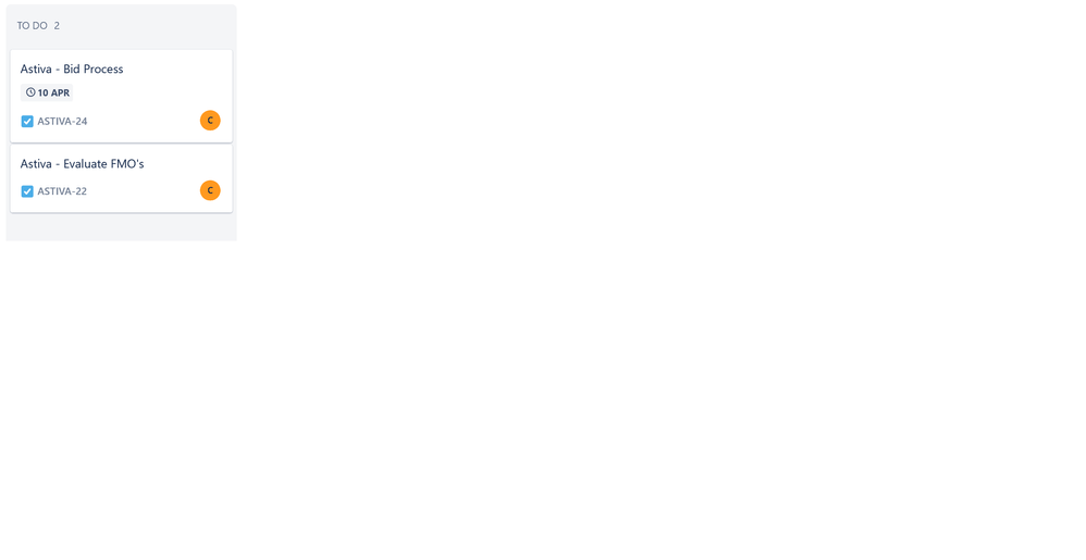

I will maybe create a couple of Classic projects and see if it works the way I need it too.  thanks for the help...you too Susan.  One last question and I think I already know the answer.  My user wants to know if we an edit the way the task is shown in a board.  I think the answer is no because I can't find anywhere or any documentation that says you can.  see screen shot.  My user wants to add the Owner field to this...not sure that can be done.Jira6.png
Mikael Sandberg
March 25, 2020
You are correct, in a next-gen project you cannot change what is being displayed on the board. This can only be done if you are using a classic project.
