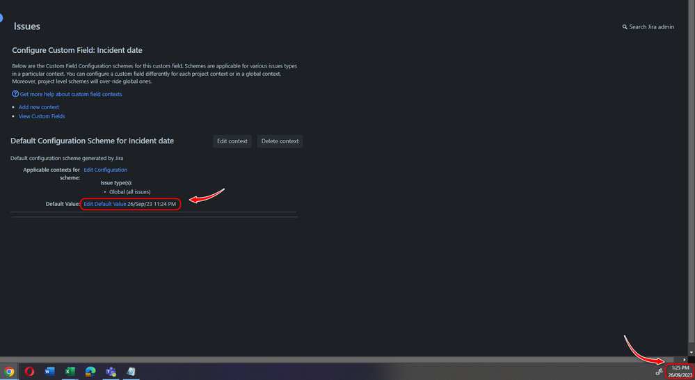

Hi all,
I create a custom field to take the current date and time when an issue is created.
However, the default time is not the same as the current time. In my example below, the default is showing as 11:25PM, when I created that on 1:25PM as shown in the system date on my computer.
How can I fix this?

Hi @Trudy P Claspill ,
The time discrepancy is due to the time value when I set up the Default value (it took the current time). And when creating an incident, whatever the time when I saved the custom field, it will set as default.

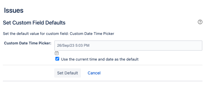

Actually, I don't seem to be able to recreate quite the same problem in my Jira Software Free subscription.
I have a custom date/time field for which I set the default value to current date/time. In my profile timezone of America/Los Angeles it is currently 9/27/23 at 12:03 am. The time that is shown in the custom field is 7 hours behind, but if it was using UTC I would expect it to be 7 hours ahead.
If I wait a few minutes and then try to create an issue that includes that field. I see that the time is updated to reflect exactly 7 hours behind my current local time (which is now 9/27/23 12:10 am).
So, I don't seem to be getting a hard coded value coming through when I actually create the issue, but I'm also not getting either a date/time that matches my timezone setting or the correct date/time for UTC.

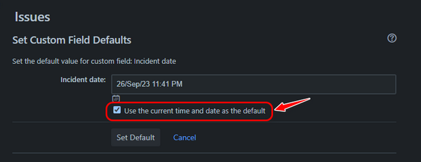

Zaldy Parian
September 25, 2023
Btw, this is how it looks in the default setting....
