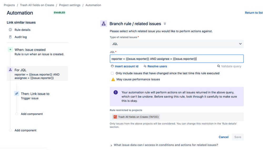

I think that the use case you described can be accomplished with Automation. Here, you could configure a rule which will look up similar issues and link them to the main ticket. Next, with the help of our app - Extension for JSM, you could display a preview of all linked issues on the Customer portal.
So, to start with, you could write the automation rule as follows:
  • When: Issue created
  • Branch: For JQL
    It will find similar issues raised by the same customer that relate to the same serial number. Please find an exemplary JQL below:
    reporter = {{issue.reporter}} AND assignee = {{issue.assignee}}
    ℹ️ Remember that you would need to replace the assignee with your customfield (the one where the serial number is stored).
    • For that branch:
    • Action: Link issue to trigger issue
The above rule will find all related issues and automatically link them to the source ticket. At this stage, you could use the Display Related Issues feature from Extension app to display a preview of the tickets on the Customer portal.
I hope you will find the suggested approach useful. I encourage you to give it a try on a test instance to see if it meets your requirements.
