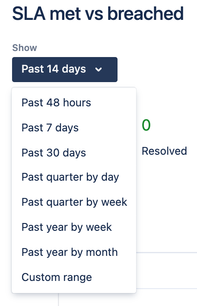

On Jira Service Management reports, you can change the date range by clicking on “Show”:

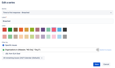

If it’s not showing the expected results, then it’s necessary to confirm if the JQL added to the series will return results older than the previous weeks. You can try copying the JQL and filter by the series. For example:
Then, going to Filters > Advanced search it’s possible to use the JQL to search for the tickets:
Organizations in (xxxxx, "xxxxxxx", "xxxxx") AND "Time to first response" = breached()
Searching directly on the advanced search will help understand if there is something missing and affecting the results of the reports.

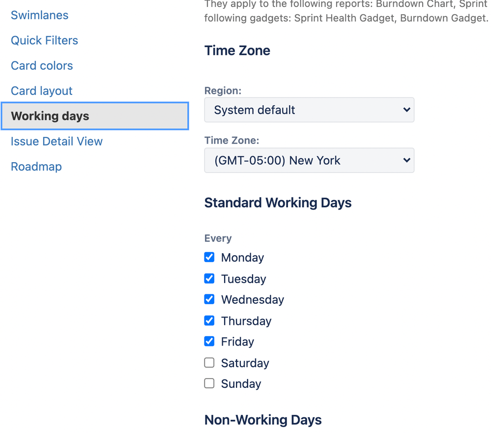

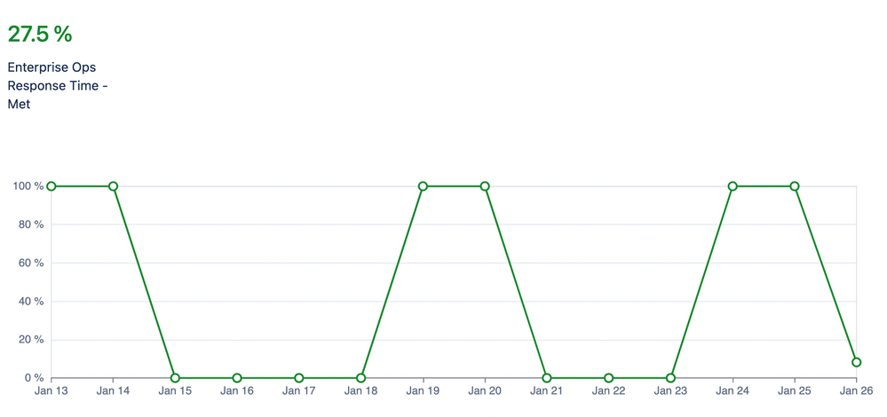

Do you know how to omit non-working days from the results?

Regarding the working days on the reports, it’s not possible to remove the weekends. This is because the reports are based on JQL and currently, it’s not supported to filter specific days via JQL.
There are feature requests suggesting improvements for that:
Please, click on Vote for this issue and also watch it to receive updates from our product managers.
