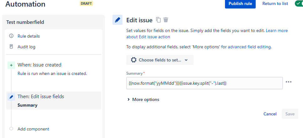

You can du this with Automation and apply this to your custom field
{{now.format("yyMMdd")}}{{issue.key.split("-").last}}
Here is an example of such rule. Notice I used the Summary field, but you shuld change that to your customfield.

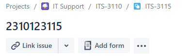

The result will be like this:
Edit:
I now see that you don't want the day. Simply remove "dd", so it is like this:
{{now.format("yyMM")}}{{issue.key.split("-").last}}
Notice MM must be capitalized.
