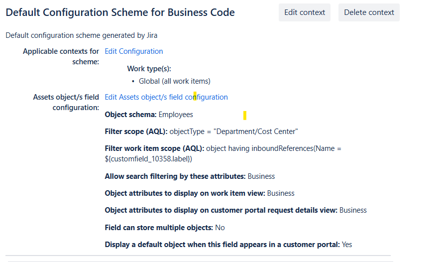

This is driving me crazy and I'm so close.
Object Schema = Employee
Object Type: Department/Cost Center
In my Object type Department/Cost Center I have the following fields
Key
Business
Name (Identifier)
Program Area
In the configuration I have put
Allow search filtering by these attributes: "Business"
Object Attributes to display on work items view: "Business"
Display a default object when this field appears in a customer portal: Yes
It will only display Name (Identifier).  How do I change it to display Business and not Name?

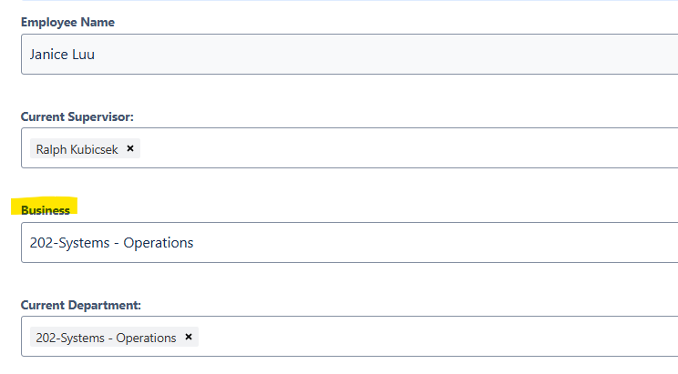

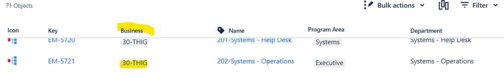

Janice Luu
July 6, 2025
I have attached the screenshot, I believe display on customer portal = business is what I want, but as you can see it still display the name field

Janice Luu
July 21, 2025
Hi Jan,
Sorry I didn't realize I closed it.  The workaround for it is if you want an object to show you, then you have to make that field an object itself.  For my example, I created another object and added Business and made this a link object.  Now it shows up.
