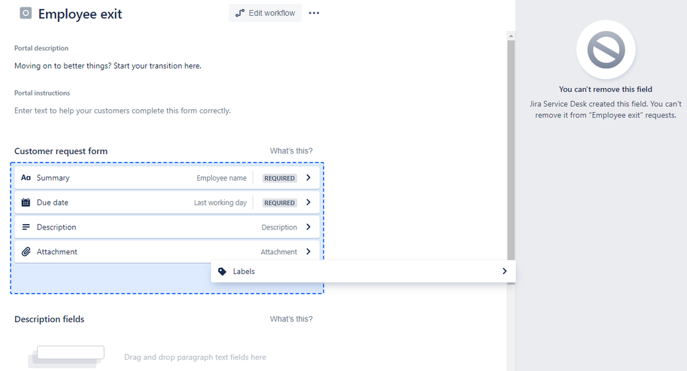

I tried to remove it from request types, not to be shown in the interface but it is preventing me with the following message: Jira Service Desk created this field. You can't remove it. So, the only think I can do is to hide it.

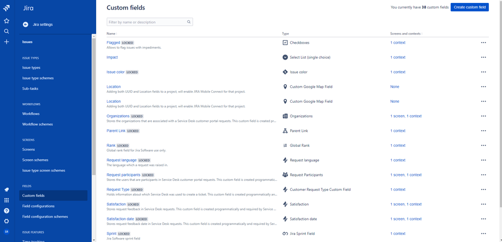

Before that, I deleted the label custom field from Fields\Custom Fields and in Screens (Default Screen and Resolve Issue Screen), label is not showing in Field tab but nevertheless it is showing in Raise a Request and Issue interface under description.

I suspect what you’re running into is the fact that Jira service desk by the fault has a system field, called labels so you should avoid creating one with the same name. It is likely that you’re getting an error because you’re trying to remove the system field. Now, regardless you should be able to remove the field from the form itself - project settings > request types > edit fields and use the remove link to remove labels.

In the demo version there is no edit fields in request type but only to drag and drop to the container to the right. What is left for me to do is to only hide it.

I try to drag and drop but the system does not allow me.

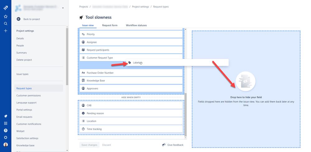

i have done a quick test in a NG service desk. As you can see I can hide Labels.

I tried it in Classic Jira Service Desk under Requests and can hide Labels by moving from Issue View to Hidden from Issue View.

Capture.PNGThis is what I get

No Label under Custom fields as I previously deleted it.

so you definitely cannot drag a system field to the right and remove (delete) it. You should be able to drag to the bottom under "hide fields below".

Labels is removed from Custom Fields but the system is preventing me to remove it from the interface.
