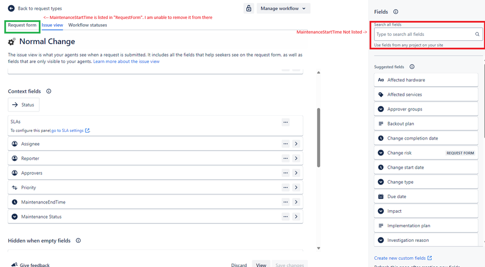

When I go to search for the custom field in the side bar, there are no results. Instead, what I have noticed is that the field is now present on the "Request Form" section. I am trying to determine what happened that caused the field to get added on that section as well as how to get it moved back to the "Issue View".
Currently when I view "Request Form" I do not have any options to move this field.

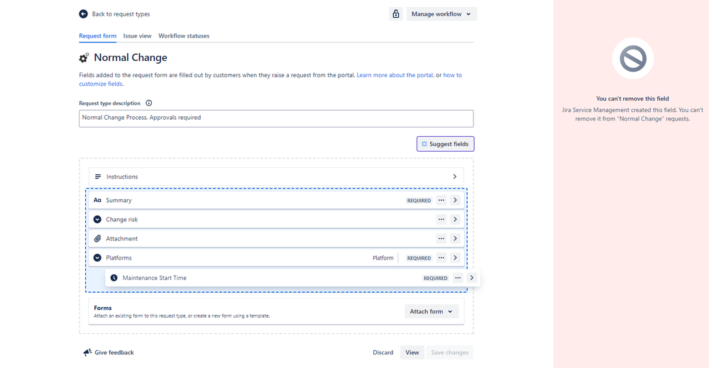

When I attempt to remove the field on the form, I get an error message saying:
"You Can't Remove this field.
Jira Service Maintenance Created this field. You can't remove it from "Normal Change" requests "

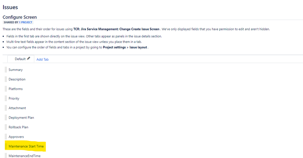

This was a custom field created by another one of my coworkers which is where the confusion comes in with this error. I'll see about removing it from the issue screen and then adding it back.
I removed it from the View Issue Screen and then added it back. It still looks to be in the form and unable to remove. I am scratching my head on what would have moved it to the forms as I previously had it on the Issue View.

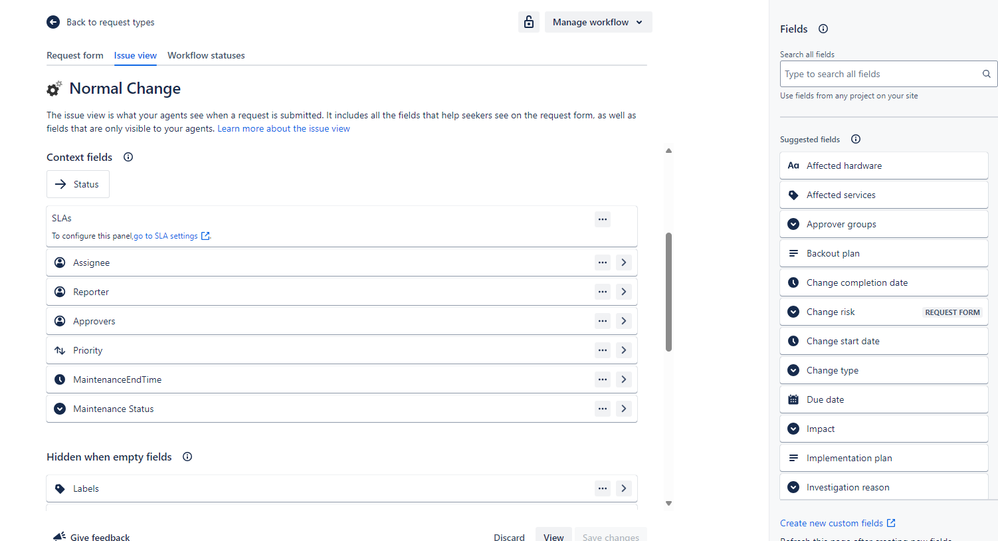

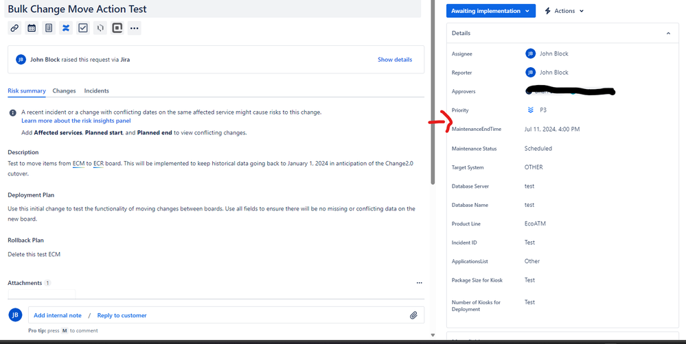

John Block
July 12, 2024
Absolutely, this is what the SLA field looks like:

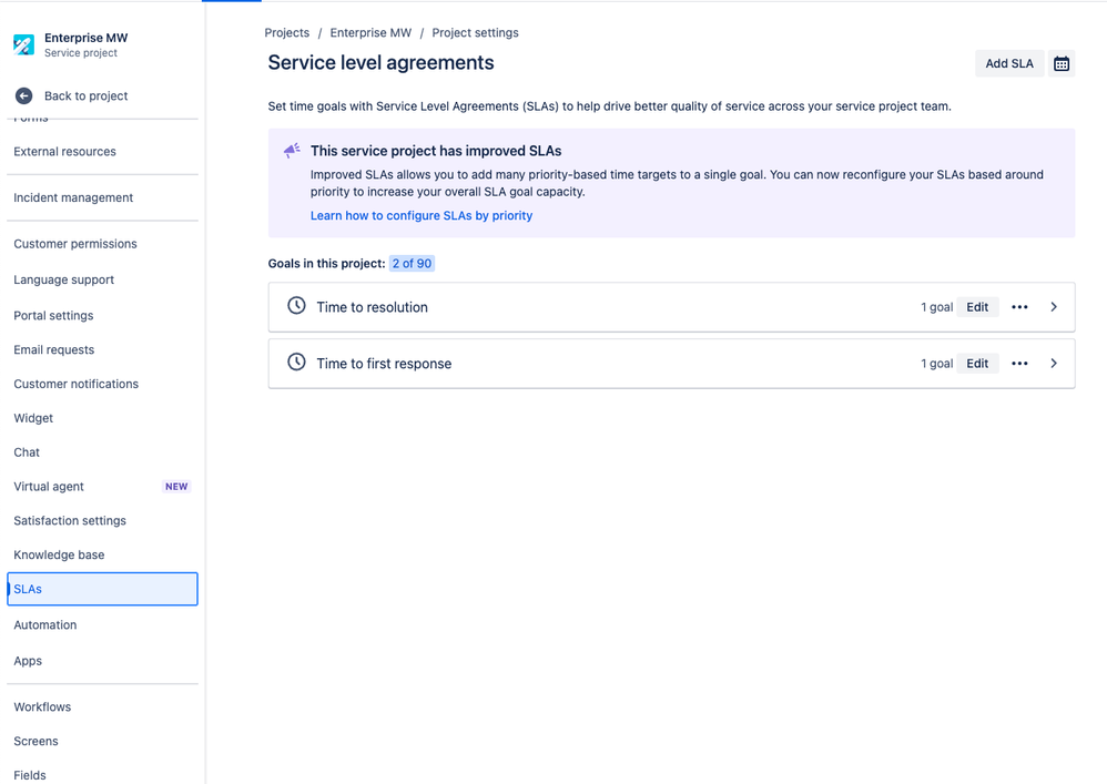

Scott Schellhardt
July 12, 2024
Hey John,
That actually looks like the request type issue view. This is the SLA page I am referring to:
You can find this under the Project settings in the SLA tab. This is where SLAs are configured based on fields.
If I am not correctly interpreting what you are asking for, please let me know !
John Block
July 12, 2024

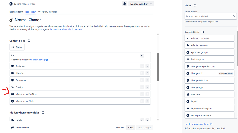

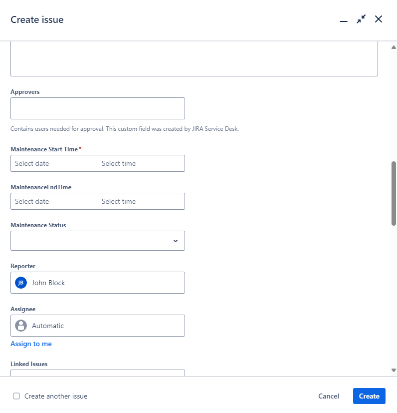

I don't believe SLA will be applicable since the "MaintenanceStartTime" is a custom field not used by SLAs. When the user creates a Change Request here is where they fill out this field.
From there when I view the request in Jira, the field is not present. I'd like to have it listed right above the "MaintenanceEndTime". When I go to configure the field views for this, I notice that "MaintenanceStartTime" is not listed as an available field to add.
