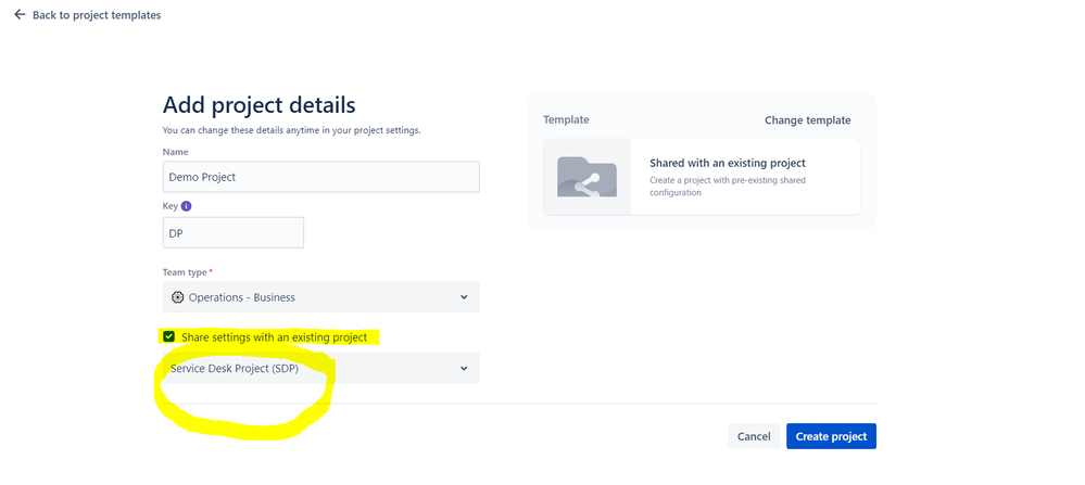

Hi,
Once i start to create a Service management project i can see option is
Share settings with an existing project.
if i select the check box and select any existing project will all the configuration changes(workflows, Screens, screen schemas, Notifications, notifications schemas etc. ) will copy from the exiting project to new project?
Is it Yes/No please suggest me the same.
If Not what is the main usage of "Share settings with an existing project"
Thanks,
Rilwan Ahmed

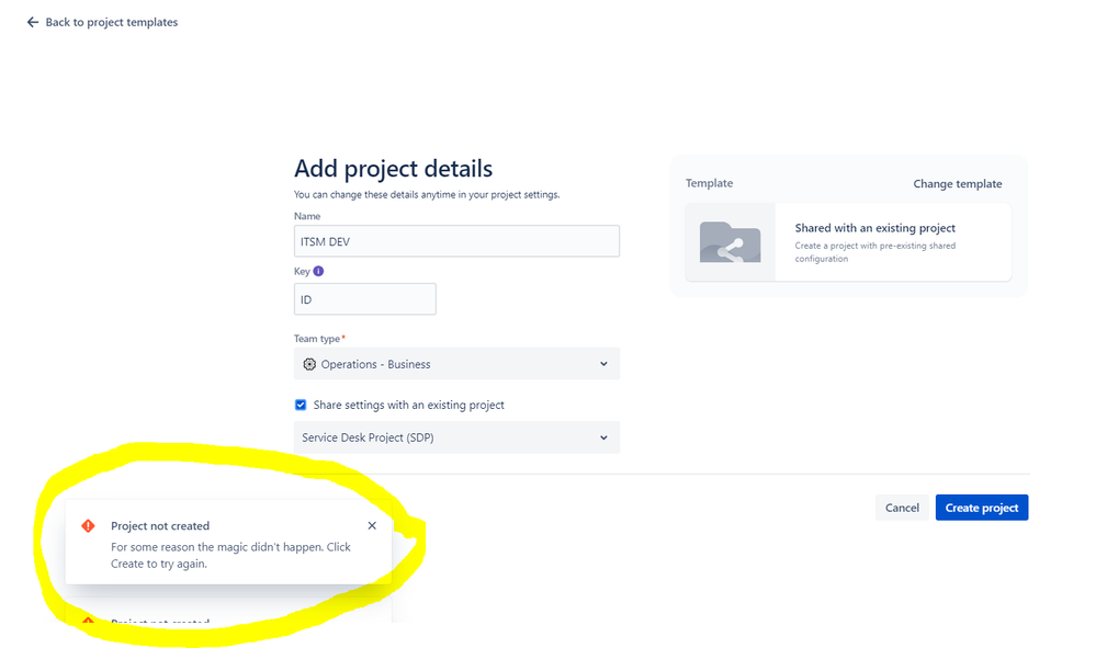

Sreenadh
November 18, 2022
I am facing the issue while creating the project with
Please find the below screenshot
Rilwan Ahmed
November 18, 2022
hi @Sreenadh
Logout, login back and select the template same as the existing project template and retry.

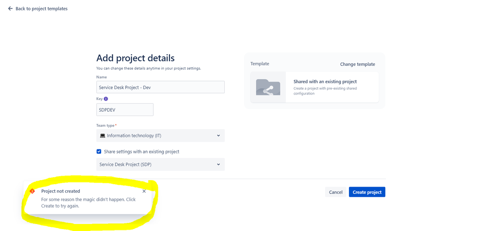

Sreenadh
November 18, 2022
Hi,
Still i am facing the same kind of issue please find the attached screenshot for your reference.
Even i have tried with the different browser as well still the same issue which i am facing now.
