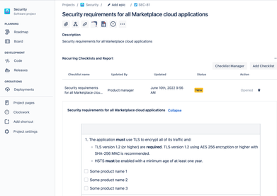

Another solution you can try out is the Recurring Checklists and Report app.
My team has developed it for managers to always know what needs to be done. So, you can convert your task into checklists. The system will automatically create an issue with a checklist.
Here is an example of how a checklist looks in the task created by the system:

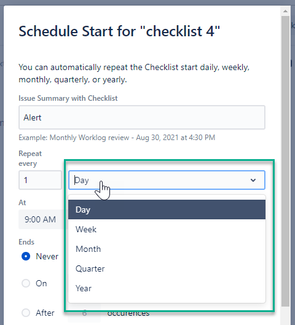

What about 60, 90 or yearly alert, use Recurring.
