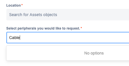

And regarding your concern if someone tries to bypass one of the fields, all that happens is that no results will be shown. Here is an example from our peripheral request, if you do not select the location you will not get any results back:

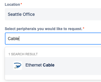

And once you select a value in the parent field the filtered scope field will return results:

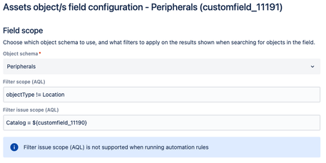

So the customfield_XXXXX is used because that will never change, but you can change the name of the field, and the field name is not unique so you could end up in a situation were you have two fields with the same name. By using the customfield_XXXXX you avoid getting nothing returned in that case.
Here is an example of how I use it. For our peripheral requests that I mentioned above we have different catalogs depending on your location. The configuration for peripherals looks like this:
The filter scope excludes Location because location and peripherals are within the same Object schema. The attribute Catalog in Assets is linked to Location object, and on the request form I have a custom field called Location that is liked to those objects.
