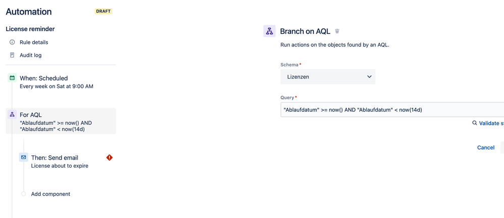

Hi @Emma Hay,
the following setup should work for you (Ablaufdatum is my "License Expiry Date"):

Hello @Kai Becker
Thanks for your help here! My mistake was not creating a new branch. I was creating a new object condition which in hindsight is rather daft. Really appreciate your help here. Got the automation working smoothly now.
