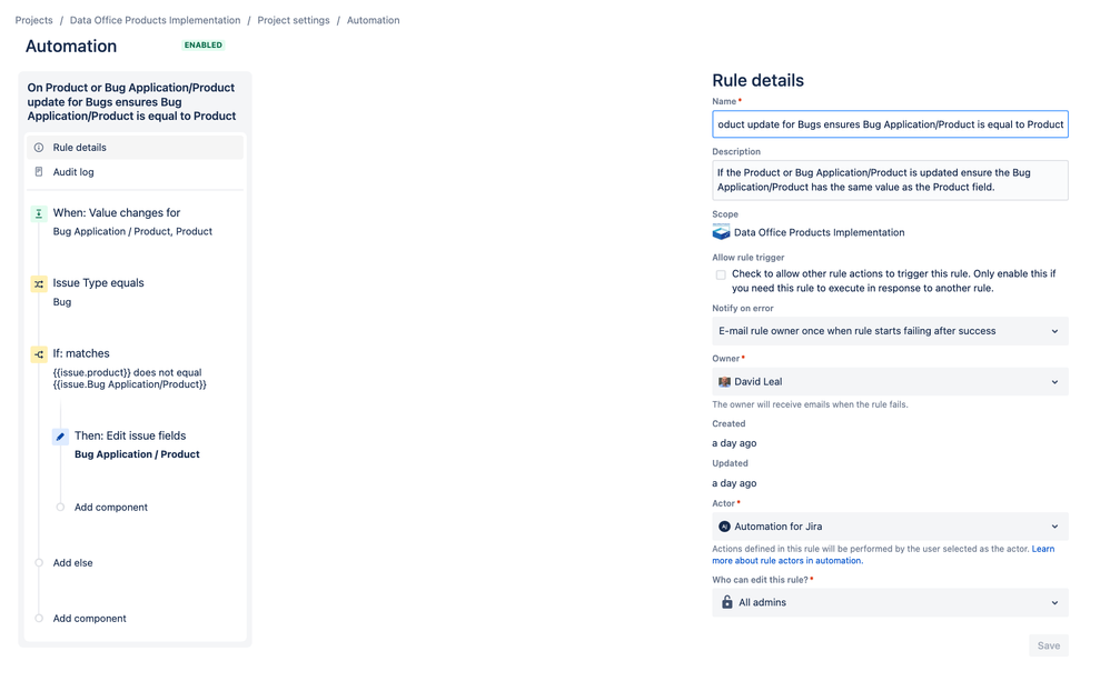

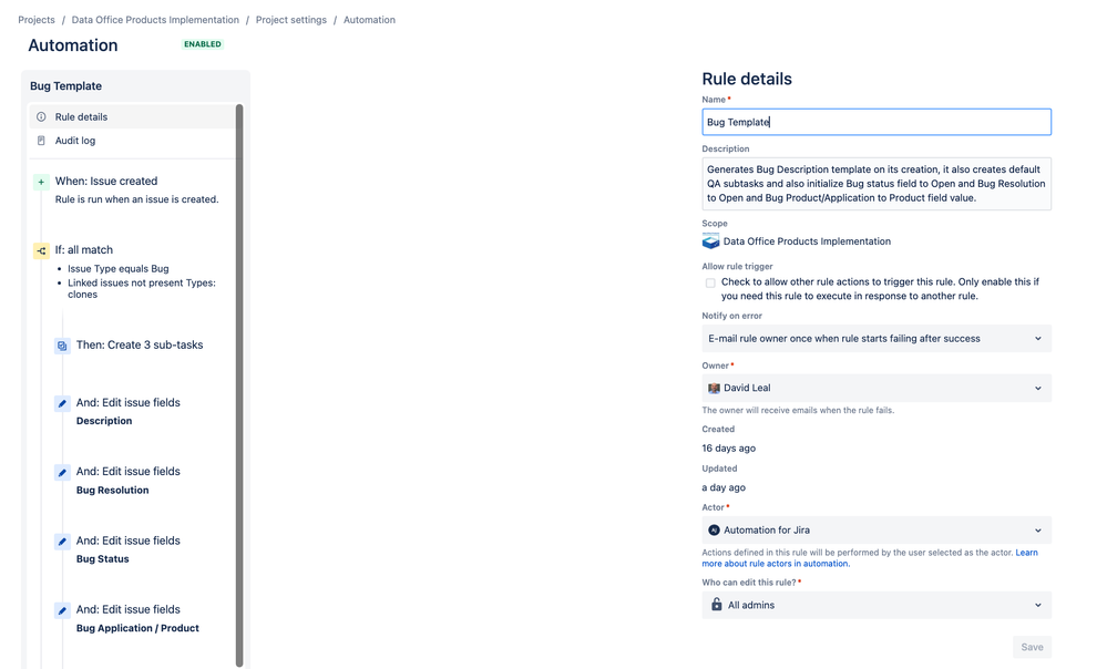

@Ste Wright That is what I suspect the Allow rule trigger forces the rule to be executed sequentially. The first one is on issue creation (rule 1), where the field is updated. Here is the rule 1:
As you can see Bug Application/Product field is assigned, but also in the second rule (rule 2):

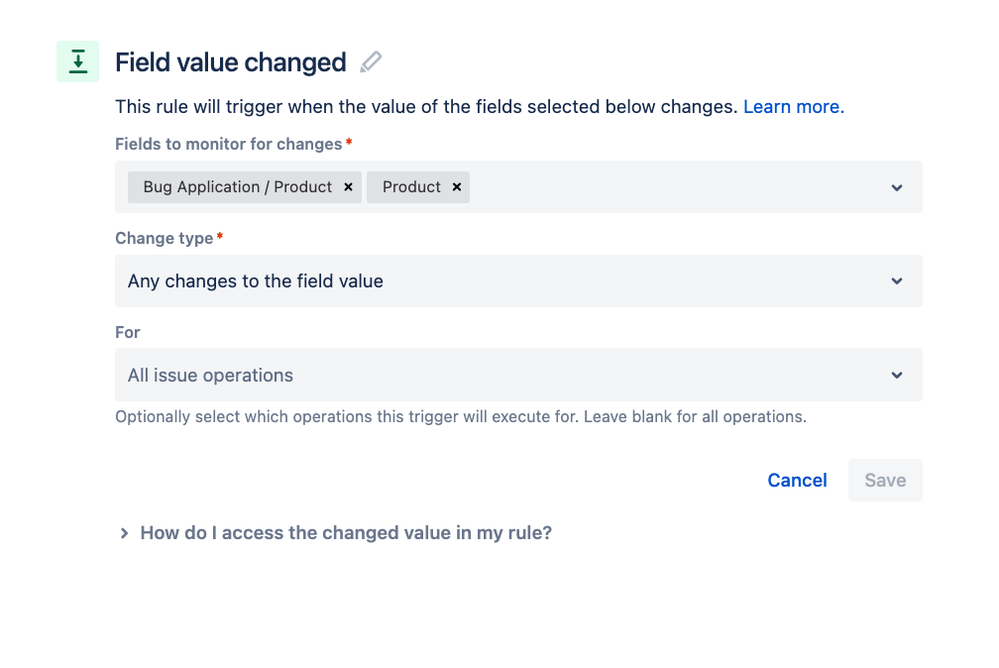

The same field is updated. For this rule, the trigger condition is for any change and for any issue operation:
so both trigger condition applies to issue creation, so both are executed on any other.
Now if rule 2 I mark the option: Allow rule triggerthen rule 2 can be executed in response to rule 1, so I can remove the Edit issue field for the Bug Application/Product field in rule 1 since rule 2 will be in charge of that. I updated both rules.

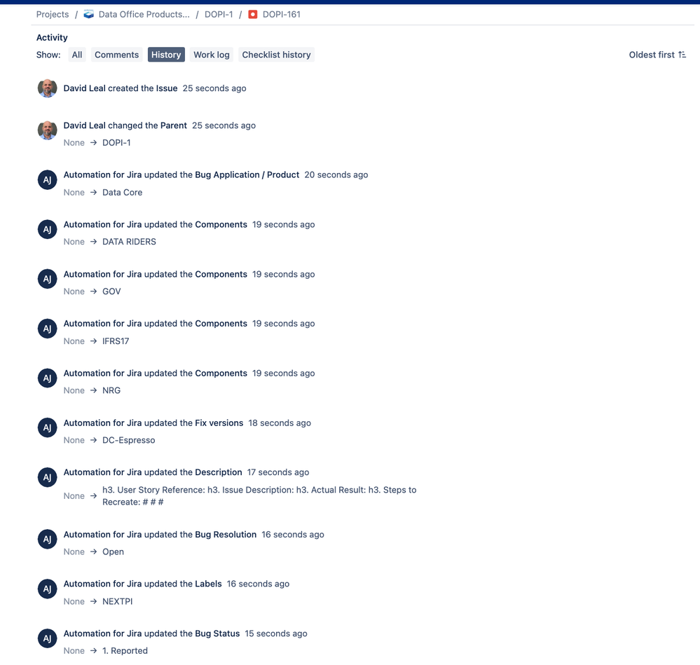

Looking at the Bug history (sorted by older first) both rules are executed and Bug Application/Product field gets populated, but I am not sure about the sequencing. According to the history of the action in the Bug (in case it sorts the entries properly because the tracking time is the same).
It looks rule 2 goes before rule 1 because Bug Application/Product was updated first.

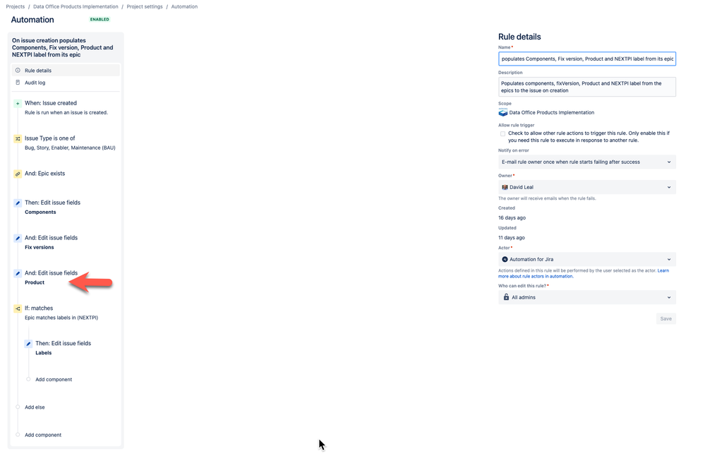

Then I realized I have a third rule (rule 3) that is triggered on Bug creation too. This rule assigns the Product field value and also Components, Fix version, etc. from its corresponding epic. The value of the Product field is used to set the field Bug Application/Product on rule 2, but in the history, it doesn't appear the Product field was assigned (to Data Core) even though it was used to set the value of Bug Application/Product field with the correct value. Here is rule 3:

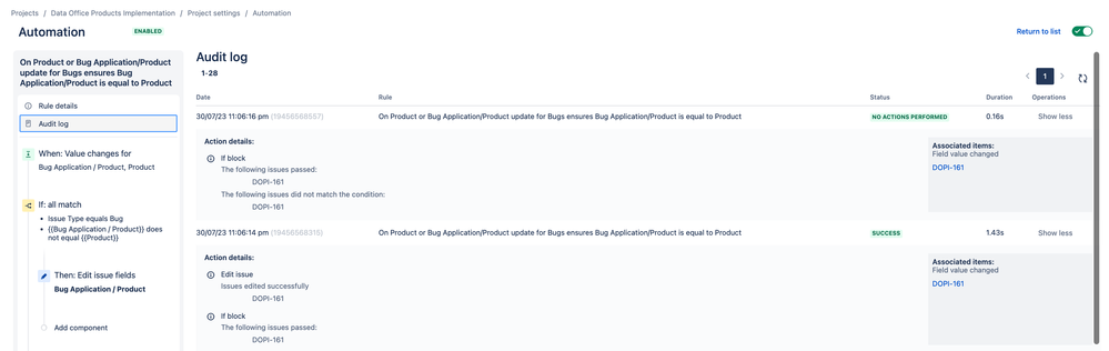

Researching more, rule 2, is executed twice: I would say after rule 3 and rule 1 (both on creation), but it is just reflected once in the history because the field Bug Application/Product is updated just once:
Maybe it is a complex scenario to follow, the fields get updated as I expected, but the order of execution is not expected.
Maybe the sequencing is correct, but the history doesn't reflect the proper order, still a mystery why setting the Product field doesn't appear in this history of the Bug and why rule 2 seems to be executed first.
