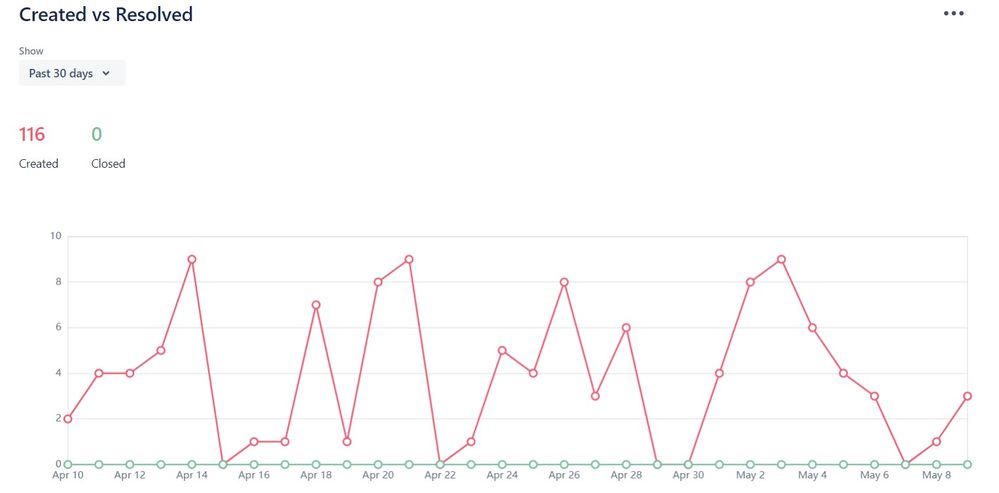

I am facing a challenge to get the correct data from created vs resolved issue report with in the given period of time.
As you can see that in below screenshot all the issues in report is showing against created whereas most of the issues have closed. 111.jpg
Please look  into this and do the needful.
Thanks
Nic Brough -Adaptavist-
May 9, 2023
"Resolved" in Jira means that a resolution has been set on the issue (it can be any value, "unresolved" simply means there is a null/empty value in the database field).
Your graph tells me that your admins have neglected setting a resolution when your issues are closed.  They need to change your workflow so that it either asks a user to choose a resolution when they close an issue, or set it automatically with a post-function.  (And clear it on any form of "reopen")

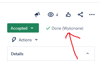

Hello,
check if your issues are set with any "Resolution":
Maybe you messed something up with your workflow, and it does not set the resulution on transitioning to done statuses.
