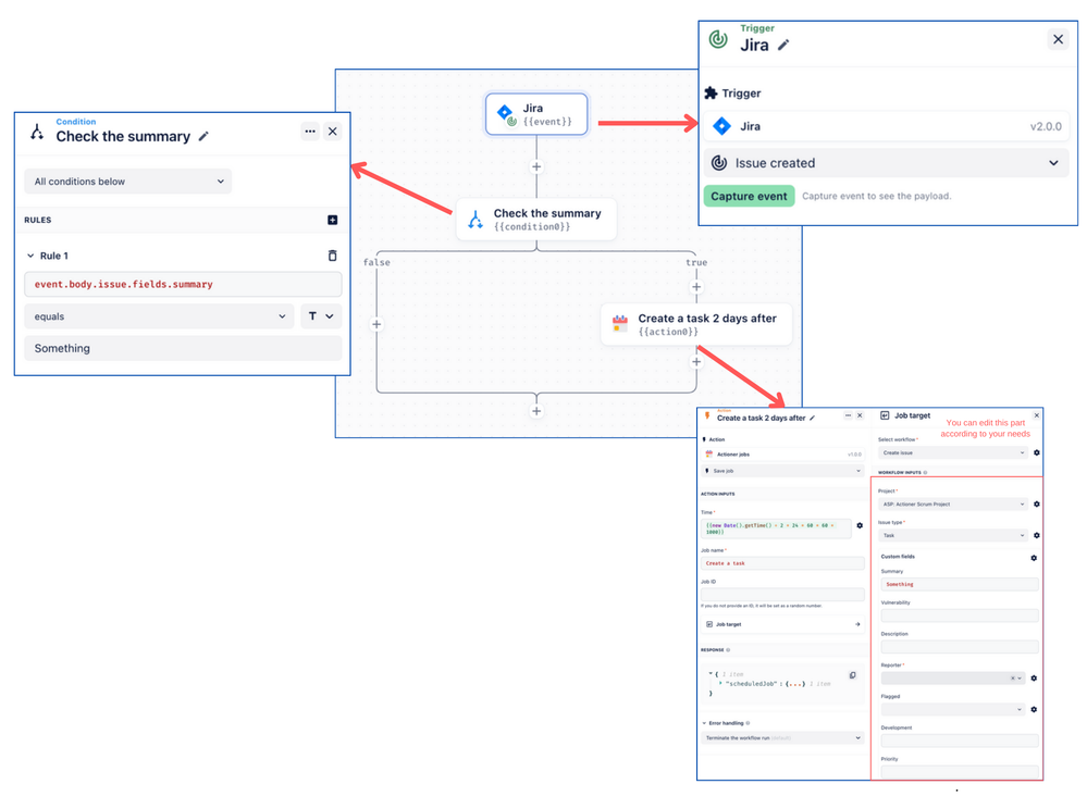

Hi @Jack Nicholls ,
You can give Actioner a try, a low-code automation platform that integrates with JSM and Jira. Using its scheduled job feature, you can schedule the creation of tasks.
For your scenario, here's what you can do:
1. Create a workflow that listens for newly created issues.
2. Add a condition within the workflow to check if the issue's summary meets the specified criteria.
3. If the condition is met, trigger a scheduled job to create the task two days later.
This setup ensures that whenever an issue matching the defined criteria is created, Actioner will automatically schedule the task creation process. Here is what your workflow looks like:
And you can check out the built-in Jira app.
Jira integration | JSM integration
