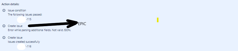

Below are my observations
1. Epic and Story were created
2. Parent of Story was not linked.
3. Based on the audit log it appears conditions were not met.

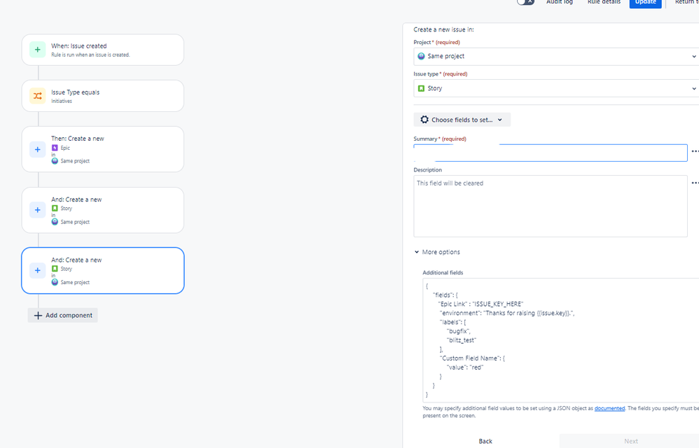

Rules to create Epic and Story

In your automation rule, after the EPIC is created, can you provide the action configuration on how you create the Story?
BTW you cannot use "Parent Link" to establish Story to Epic roll-up.  You can try "Epic Link" in the code.
Lastly, you may need to add the action of "Refresh issue data" either after the Epic is created and before your creation of Story action.  Or try to add the same action for the Story and then update the Story issue to roll up to the Epic.
Please advise.

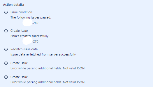

@Joseph Chung Yin - on Jira it is indicated Epic Link will be deprecated and replaced by Parent based on the cloud version I am using. So using it might not work in the long run.
As suggested I have added "Re-fetch Issue data" and "Epic Link" in the advanced section, of which came up with an error.
Rule used for Story
