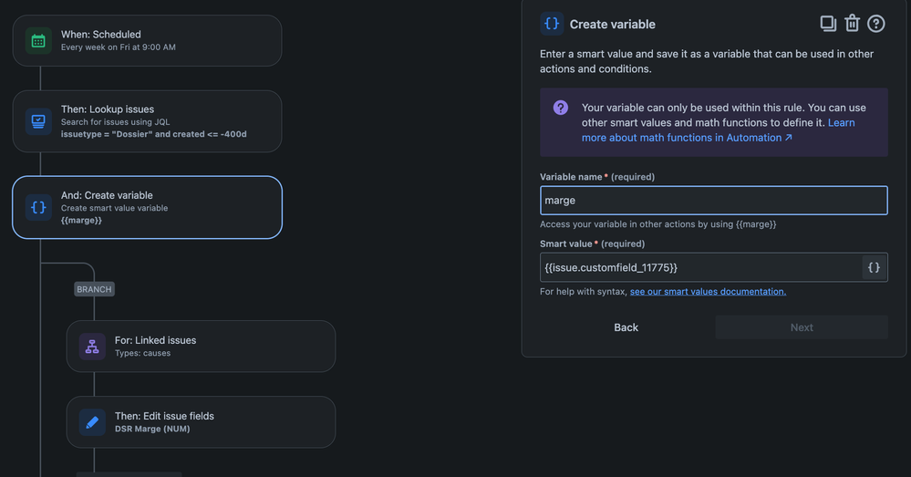

a sketch of my automation rule encolsed:Screenshot 2025-02-05 at 20.04.47.png

Rather than doing a "Lookup issue" you can insert the JQL search directly in your trigger. The option for that is quite far down when you edit the Scheduled trigger.
However just listening to a field change/issue update like @Gerusa Lobo suggested in his last screenshot would probably work even better?
Which part of the rule isn't working as of yet?

yes, lookup is just for this one-case of a bulk migration.
problem is - there can be multiple field changes, I would need to account for a general "anything changed in the issue" then.
when the rule is run manually for one issue - no problem. when you scale it up to be scheduled (and try for testing to run it) - no actions performed. Although the JQL query is validated and correct

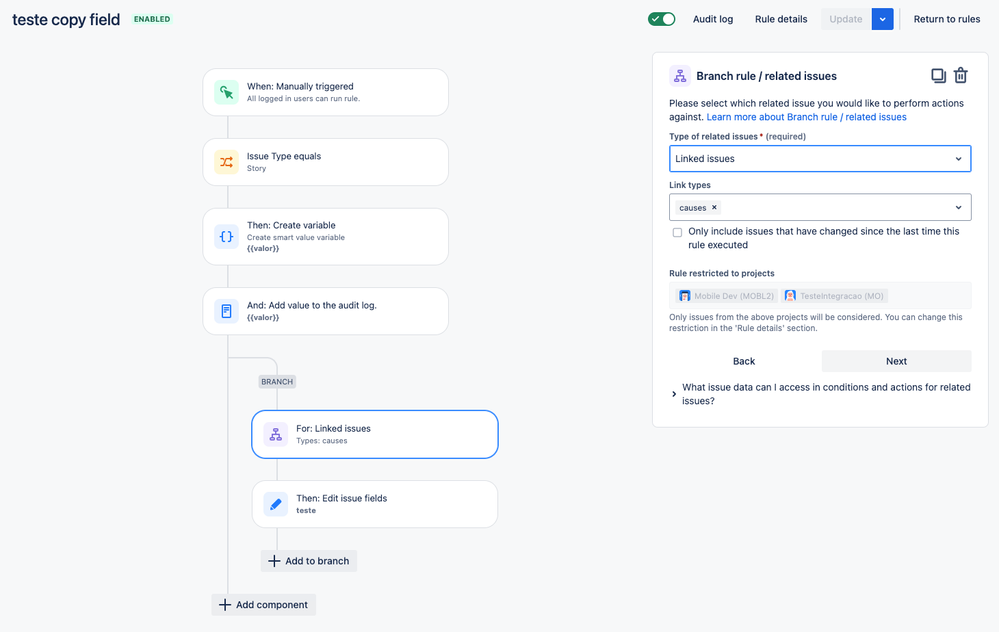

At first you can develop a manual trigger to check if the rule is ok, as in bellow:
It is important to configure the scope for both projects.

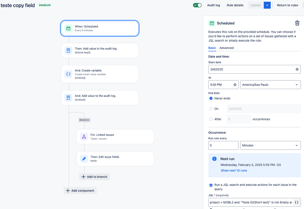

To have a periodic processing, we can use something like this:

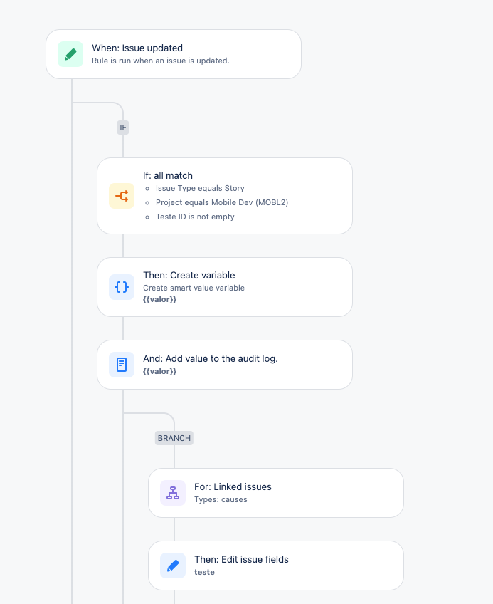

Also, to have a automatic updated, keeping all issue synchronized, you can use, something like this:

as said, yes, that would be the way to pursue, yet when scaling it (step2 as you described) up to be a scheduled rule - I get no actions performed. Although the JQL query is validated and correct.

The both projects must be in the automation scope to be able edit an issue in the second one.
You could verify it.
Also, if it is ok, the problem could be any permission for the automation actor or issue security.
I help hope you.

Gerusa Lobo
February 6, 2025
Hi @Dmitry Alabyan,
For schedule, In automation I defined the jql inside the schedule parameters.
Using that way, the automation works as a loop for all issues searched in jql.
Please, Look at the second automation image configuration in my previously post.
Dmitry Alabyan
February 6, 2025
did exactly in the same manner, I'm familiar with scheduled looping
