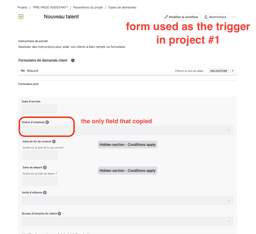

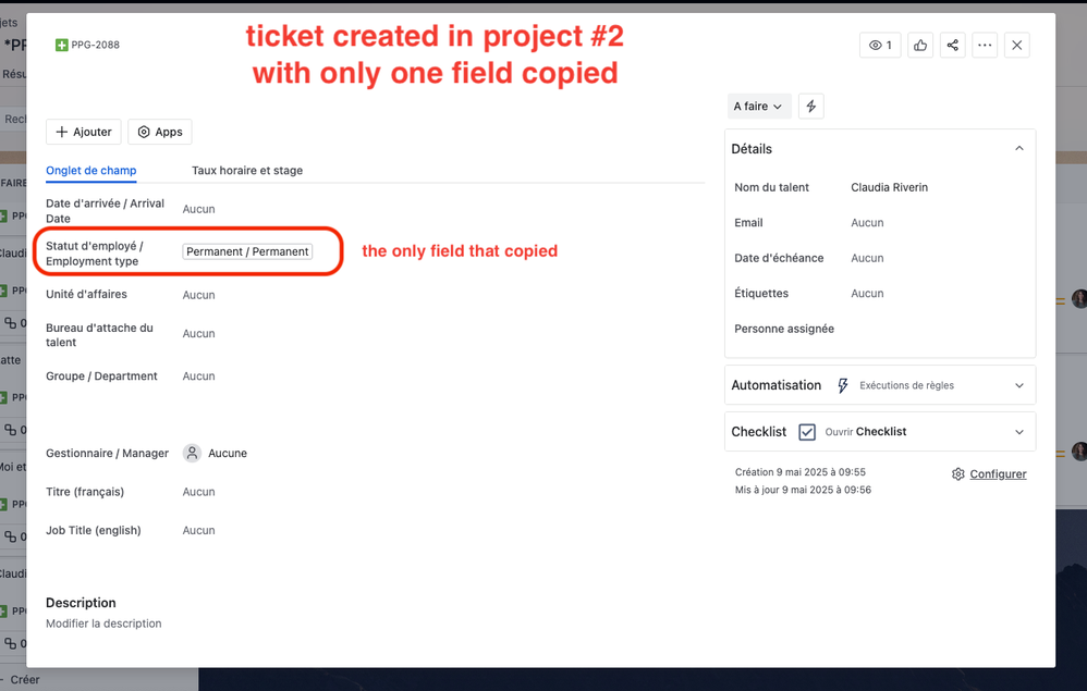

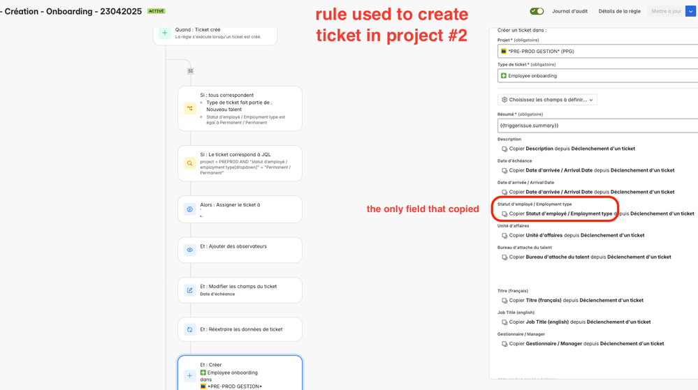

But I need to copy all fields from the form in project #1 to the ticket in project #2.
It seems I am not able to make it. Only one field is working out.
Screenshot 2025-05-09 at 10.19.03 AM.pngScreenshot 2025-05-09 at 10.17.11 AM.png
Can someone explain me what I am doing wrong?

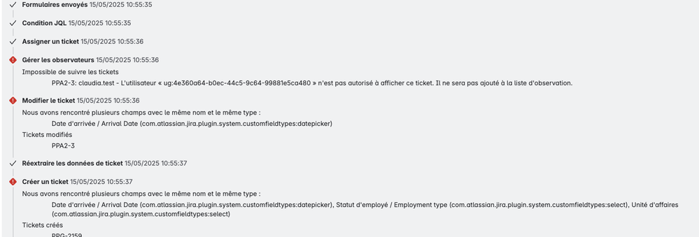

What if you change the trigger of the rule to form submitted and base this on the form used in the 1st request.
I think it's a timing issue, the 1st issue is still creating when rule 2 is also running based on issue creation.
Can you show the field config of a custom field as well?

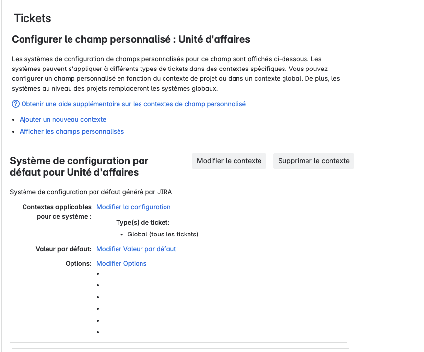

Here is a field config for two of the custom field.
Sorry it's in french.

The problem then is that 2 rules firing on issue creation run parallel at the same time, So you need to have the rule that copies the info to a new ticket based on a timer or based upon an transition?
What is you set the trigger back to issue created and then add a delay action for let's say 30 seconds, so do this action direct after the trigger, before the "if"
What is the result then?

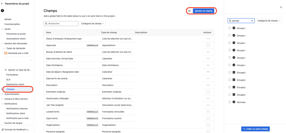

@Marc -Devoteam- Just found out that a new menu appeared in my project: FIELDS! OMG! So I have to add my global Jira field in my project from there, and after I can link them. It seems working out! Yeah!
I'll do some tests.
Thanks so much for your help!
