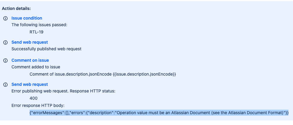

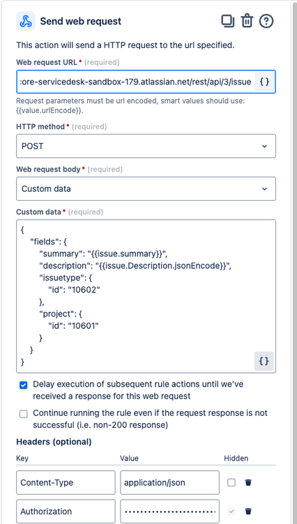

I am using a custom data, this is the web request I sent
And this is the error

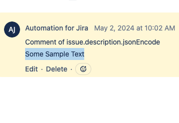

This was the output of {{issue.description.jsonEncode}} that I had put in the comment to see the value.

Hmm, instead of
"description" : "{{issue.description}}",
have you tried below JSON in its place,
"description": {
          "type": "doc",
          "version": 1,
          "content": [
              "type": "paragraph",
              "content": [
                  "type": "text",
                  "text": "{{issue.description.jsonEncode}}"
https://community.atlassian.com/t5/Jira-questions/Getting-Error-quot-Operation-value-must-be-an-Atlassian-Document/qaq-p/1304733
https://developer.atlassian.com/cloud/jira/platform/rest/v3/api-group-issues/#api-rest-api-3-issue-post
