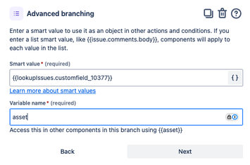

Another thing you can try is to use the advance branch and iterate over each value in the assets field.
