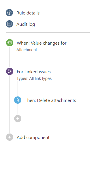

This is the automation that delete the attachments:

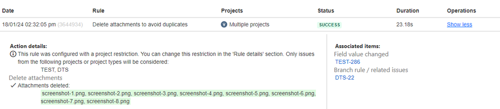

This is the audit log:

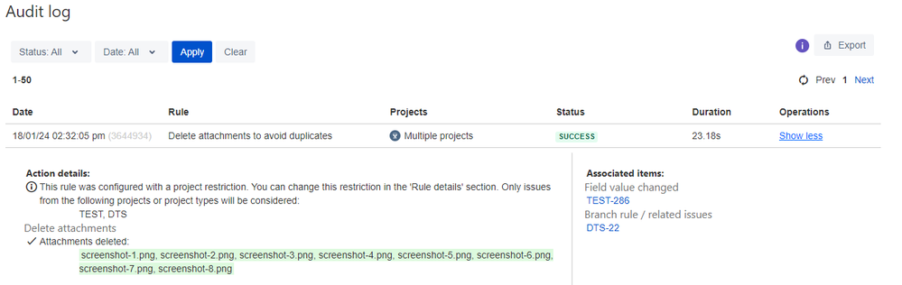

Audit log:
I just realized that the attachments are indeed being sent correctly, but then they get deleted. In other words, they are copied successfully to the parent ticket and then removed. I would need to reverse this process, deleting them first from the parent and then sending them from the child.

Your second Audit Log image is the same as your first, for the Delete Attachments rule.
I can see a few potential problems.
1. If these are two separate rules then the rule adding of the attachments may be running before the rule that deletes the attachments.
2. Your rule doesn't have any criteria about the link types of the linked issues to be affected, but you mentioned a parent/child relationship. How do you specify that one is a parent (or child) of another?
3. Do you want to have only updates to the parent attachments copied to the child, or also updates to the child attachments copied to the parent? If the latter, can there be multiple children?
4. On the Rule Details page what is your setting for allowing the rule to be triggered by actions taken by other rules?

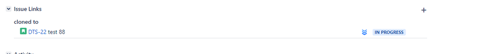

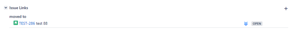

#2: In the images not, but I tried specifing the link types and the result is the same, the link types of my issues are these, moved to, and cloned to:
In this case: DTS-22 Is the parent, and TEST-286 is the child

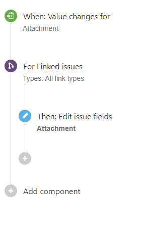

Daniel Bermudez
January 19, 2024
#2:  Not really, just ones with the link type that we have configured as: Moved to and Cloned to, but I try with "All link types" just to see if with that it would work, but didnt.
I tried with just one automation too, but again, it didnt work out...

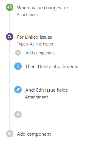

This is the automation that I tried:

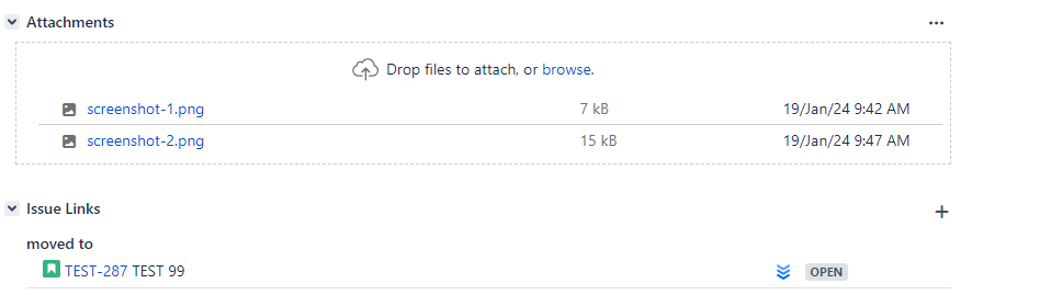

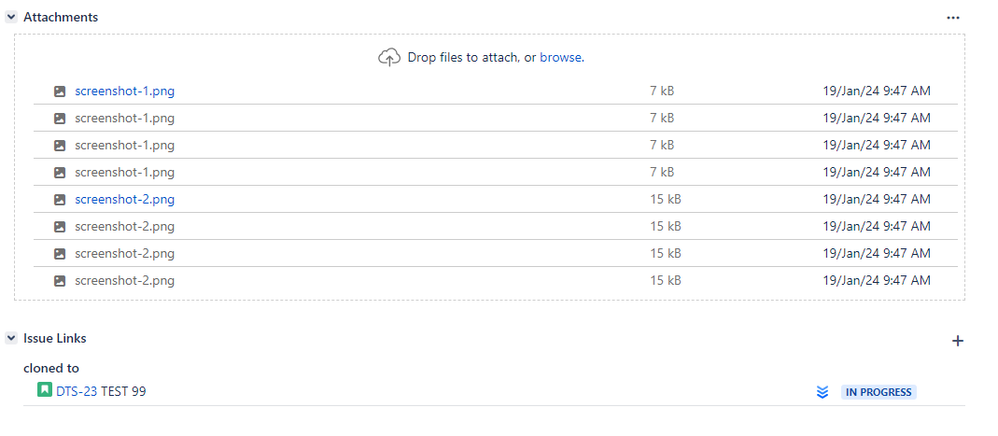

This is what happens if i run that automation:
This is the parent ticket, I just placed the "screenshot=2.png"
And this is the result in the child ticket:
Trudy P Claspill
January 22, 2024
So, one thing you need to do if you are using a single rule to both delete the attachments and then add them is add a Re-fetch Issue action in between the actions that delete and add the attachments.
