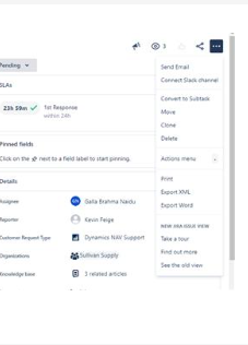

Hi @Fabian Lim ,
From your screenshot, it looks like the user does not have the "Work on issue" permission for this project.
Can you please confirm that the affected user has the "Tempo Timesheets Access" permission (https://help.tempo.io/cloud/en/tempo-timesheets/permissions-in-tempo/global-permissions.html
and if he can log work on this issue in Tempo, My Work.
You might also want to check this permission with the JIRA permission helper (JIRA Settings, System, Permission helper), and see if there is any conflict with JIRA Service Management  permissions.
In case he has Tempo Timesheets access and the "Work on Issue" permission for the project, can you please create a ticket in our Tempo support system so we can better investigate this (https://tempo-io.atlassian.net/servicedesk/customer/portal/6).

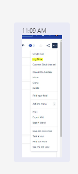

Hi Fabian,
Thank you for your response. I did check, and he is added to the team, and everyone on the team has the same permissions. Why is he not able to see Tempo as a choice in this pulldown?
Rebecca Wiley
September 6, 2021
This is what mine looks like:
