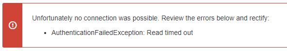

I am currently configuring a Mail server for a client and I keep on getting:

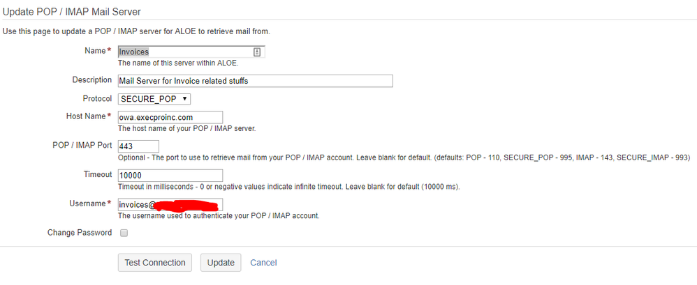

My configuration are as follows:
image.pngI had tried the other steps and recommendations from other threads with no luck.
Some recommendations say that something needs to be configured from the host's end to allow the connection.
However, I do not have access to the host server.
I tried logging in to the account via an email client and I had successfully logged in.
Any further comments or suggestions is highly appreciated!
PS. Server logs only shows:

Jira mail handlers do not support activesync / MAPI - only pop and imap
you can find more detail on this previous post  - https://community.atlassian.com/t5/Jira-questions/JIRA-mail-server-with-Exchange/qaq-p/90235

The error shown from the server logs usually means that the authentication credentials supplied for the SMTP server are not correct or have expired.  Did you happen to use different credentials at first?
Here is a help article - https://confluence.atlassian.com/jirakb/sending-a-test-email-fails-due-to-javax-mail-authenticationfailedexception-151519286.html
Also are you sure that the port is 443?  Usually it is 995 for secure pop.

That is also something which I am curious about but that is the port number that the email server admin gave me.
I had already contacted the email server admin and I will be requesting him to enable pop/imap based on the recommendation of @Craig Castle-Mead .

Was finally able to resolve this issue in the mail handlers by contacting the mail server admin.
Work around done:
Created a sub-domain for our intended emails and enabled SECURED_IMAP/SECURED_POP in that specific sub-domain.
Connected via the sub-domain configured.
So in conclusion,
This was not in any way a JIRA issue but instead an issue on the Mail Server.
