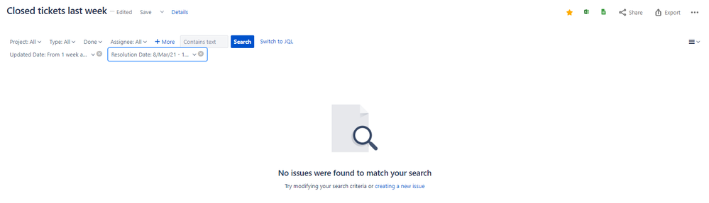

Is the creation of the closure date field a reportable field in the pipeline, please? I am able to report on created date, updated date but not closed which is more important than the other 2.
Thanks
Erika

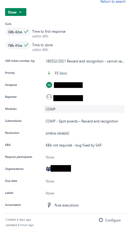

you need to set the Resolution when closing issues. Not in you image it is not set. If it were you would see a green ✅ next to the green Done status and there would be a value qualifier, e.g. Done.
you have two options (well more but we will cover the two common ones here.
  1. edit your workflow and simply add a Post Function to any unique transitions into your done category status(es) to set the field value to your desired value, e.g. done. Also be sure to clear the Resolution field using a PF on any reopen transitions.
  2. Create a resolve-issue screen and expose the resolution field to allow the user to add the desired value when transitioning to done. This screen is added to the transition. Again be sure to clear the field on reopen.

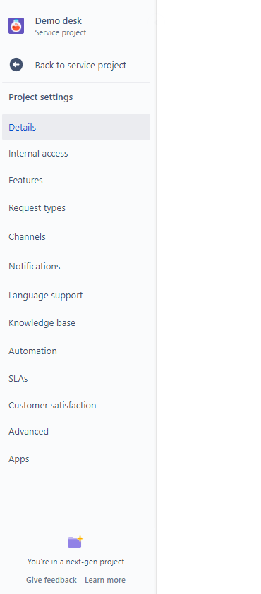

March 14, 2021
Hi Jack,
I am sorry but I am not able to follow your instructions. I cannot see the workflow option anywhere in project settings. Image1.png

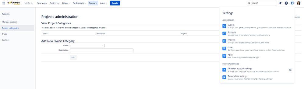

erika
March 14, 2021

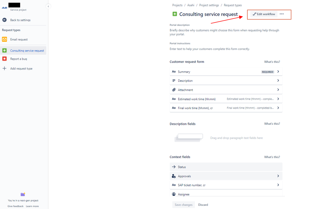

Hi Jack,
Here is additional screen shot of WF options but still I cannot see any pencil icon anywhere. We are using JIRA next-gen service manager.
Jack Brickey
March 14, 2021

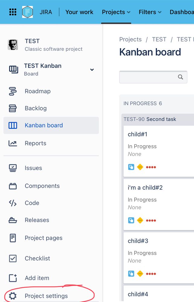

These screen shots indicate you are looking in the wrong place. I have to wonder if you are using a next-gen project AKA Team Managed Project. Can you send an image of your project page? Do you see Project settings in the side bar? If so please select and then see if you have Workflows. If so select.

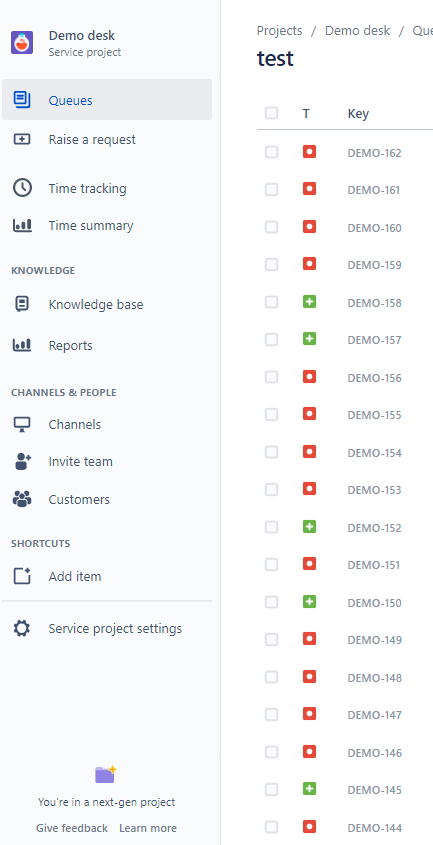

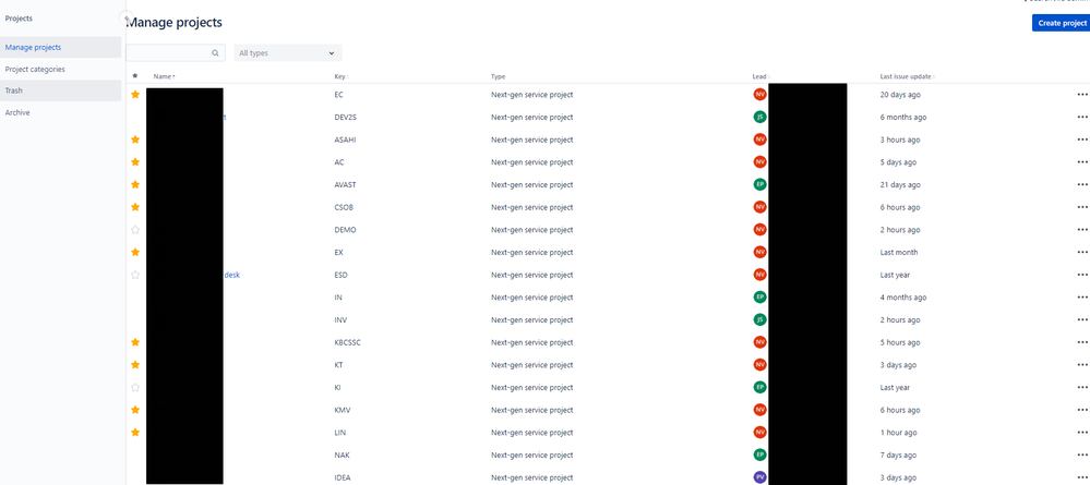

erika
March 15, 2021
Hi Jack,

Jack Brickey
March 16, 2021
I would like to see a screenshot of your specific project like below. Do you see something similar? Do you see Project settings?

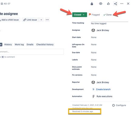

ok. so as I suspected this is a next-gen project. so forget all of the previous details above and reset here. :-(
In NG the resolution is automatically set to Done when an issue is moved to the Done column/status. This should be the right-most column in your board. Moreover, when you do this the resolution date should be set as illustrated in the below diagrams.

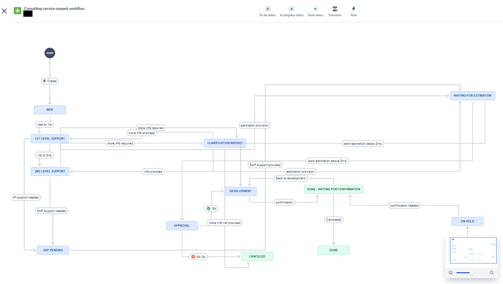

erika
March 17, 2021
Hi Jack,
sharing the screen shots. We dont have WF options in project settings but in service project settings.
Can we please agree a time and get on a phone and solve this?Image1.pngImage2.png

Jack Brickey
March 22, 2021
Is Done you right-most column of your board?

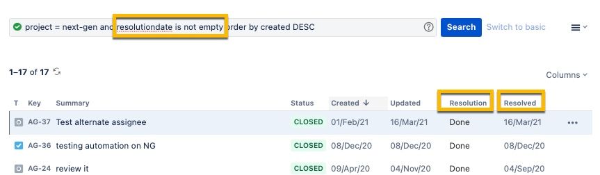

try using "resolutiondate". It should be the date when the ticket has been resolved.
Hope this helps,
Fabio

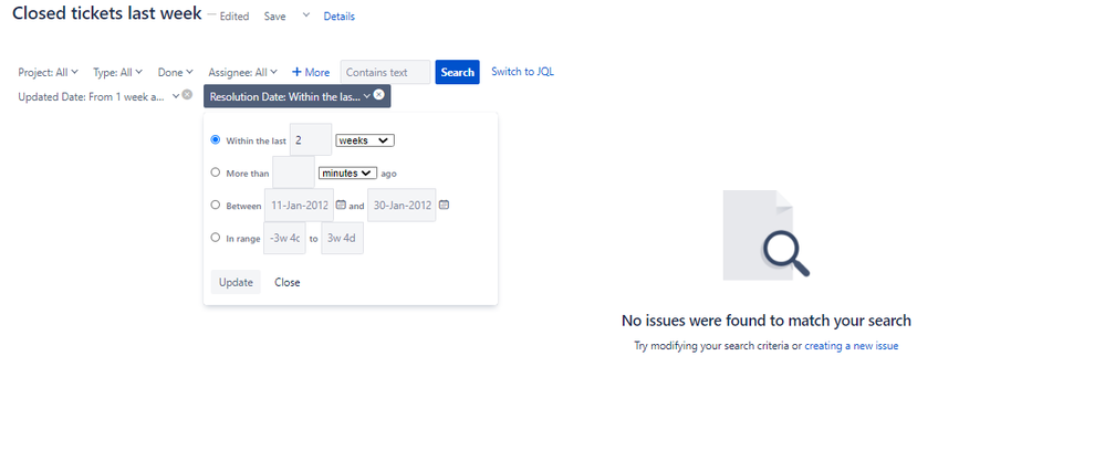

erika
March 10, 2021
Hi Fabio,
This is does not generate any data for us. Such field is not even part of our tickets.

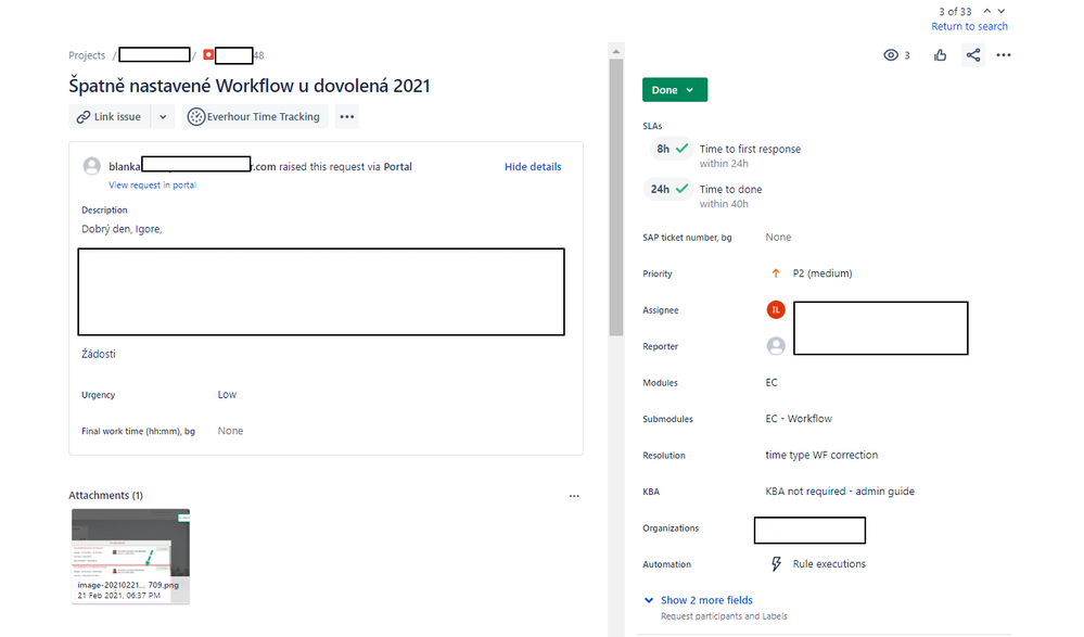

erika
March 10, 2021
Hi Fabio,
I am not sure what do you mean by having the field within the workflow, however in the screenshot you can see that we are actively using it, meaning, this field is filled out when closing the ticket.
thanks
