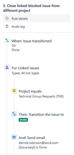

I've successfully created an automation for a Trigger issue (in project TGR) that creates a linked issue (in project DSI) & copies in the summary, description & blocks the trigger issue (in the TSR project).
Thus the trigger issue (in the TGR project) is blocked by the newly created issue (in the DSI project).
I would now like to setup an automation to close the trigger issue (from the TGR project) when the linked issue (in the DSI project) has been worked upon & transitions to Done.
However, this just doesn't seem right & I need some help / confirmation:

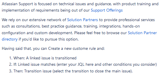

I reached out to Atlassian, but received this response:
Which doesn't provide the help I need, since I can't find a trigger for "When: A linked issues is transitioned".
I'm therefore reaching out to the community to see if someone can point me in the right direction.

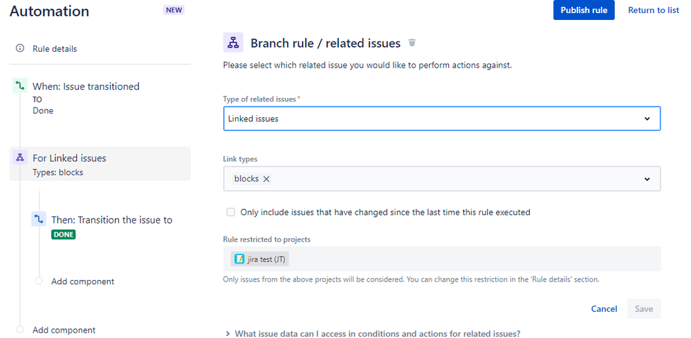

Hi @Derrick Robinson
I would suggest starting with an "issue transitioned" trigger and then checking for linked issue (with "linked issue" branch) for the required link type. Could look like similar to following:
Please let me know if this works.

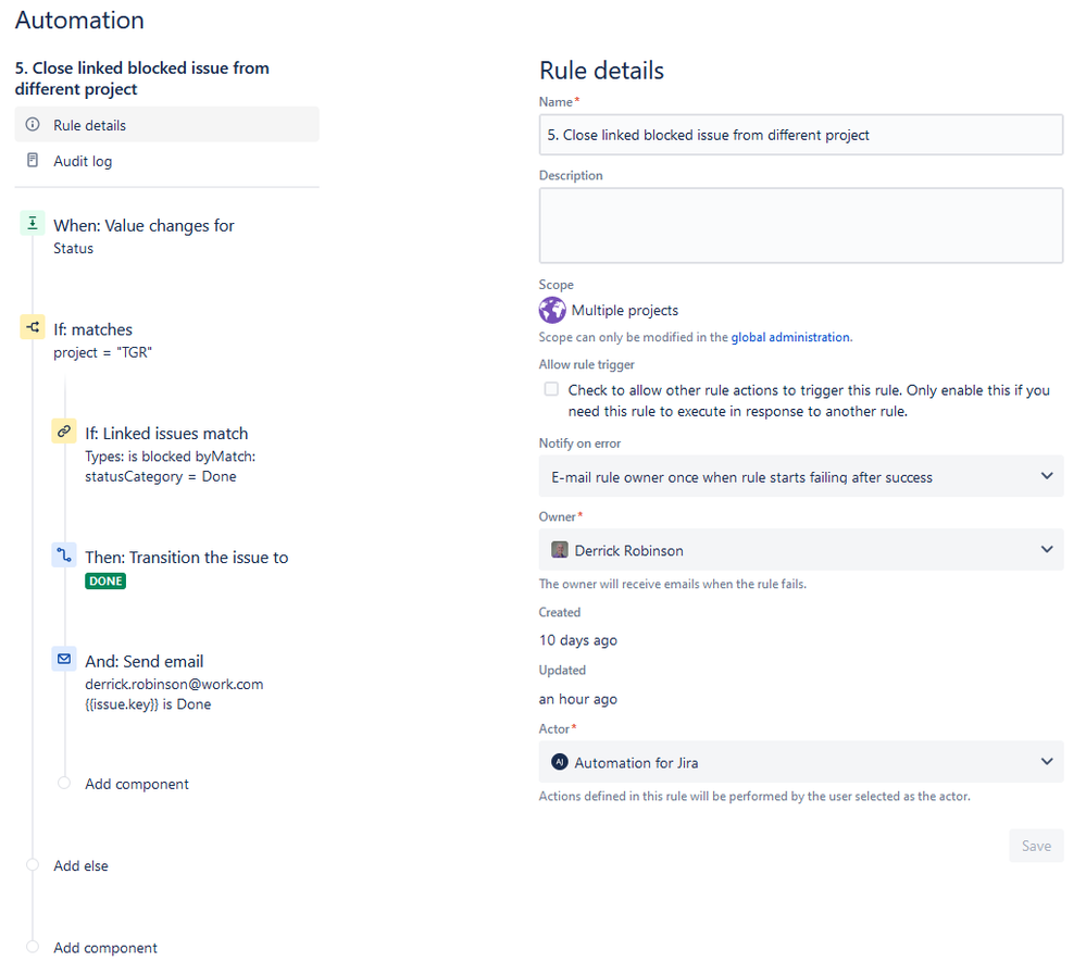

Derrick Robinson
April 5, 2022
Hi @Stefan Salzl
Thanks for your feedback. TL;DR = Yes it worked, eventually.
I had to change the Rule so that would work across multiple projects & then set a condition to check if the project equals TGR, so that it would only affect the TGR project and not all other projects:
So, the good news is that is working & huge thanks for pointing me in the right direction.

Stefan Salzl
April 6, 2022
Some time ago I built something that sounds similar to your mentioned requirement. Please see the attached screenshot (statuses might be updated according to your settings):
Please keep in mind:
this rule triggers everytime an issue is transitioned to done (in regard of some limits of rule executions depending on your pricing model)
