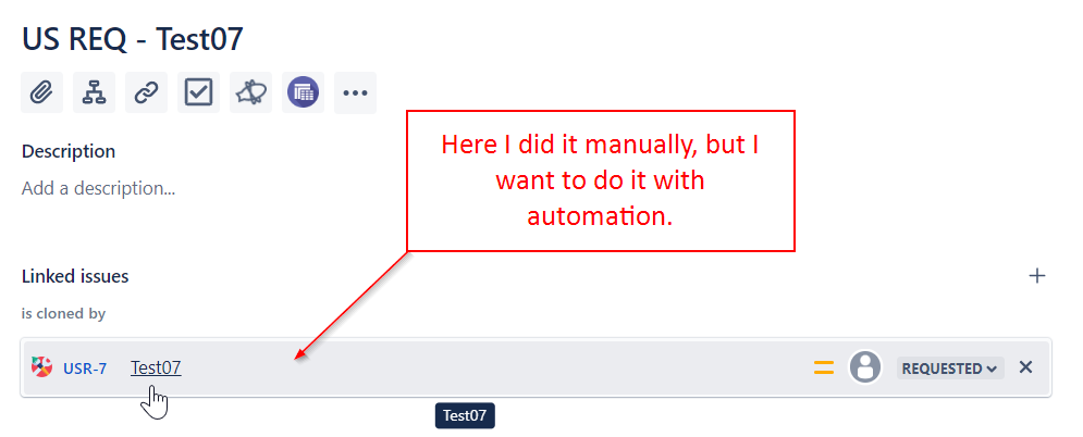

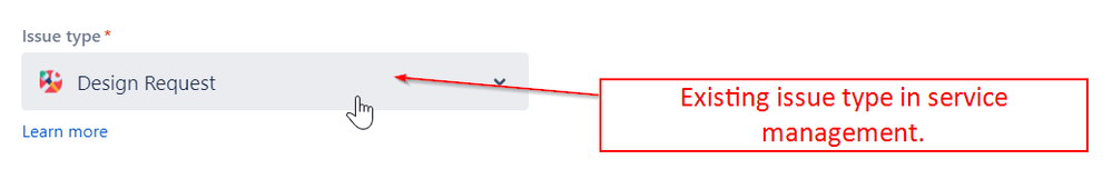

I want to clone the incoming service management request to another project (kanban board) by automation.  To do this, both boards need to have the same issue type. When one is a different issue type that I created and the other is the default task, the content of the cloned task cannot be cloned. However, I cannot add the same issue type to the project where the tasks will be cloned, I can only create a new one. I don't know why. Maybe because it is team managed project. I would like to get your suggestions. Issue-type.pngIssue-type-2.png
I'm open to any suggestions. I need to clone service requests on a different project (kanban board).

Jira is trying to be helpful by providing you suggested issue types. You could select on of those and click Add to create it, or you can create an entirely new issue type. You just need to click on the Create issue type button. That will give you the option to create a new issue type and specify a new name for it.

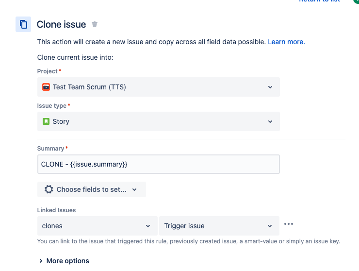

With Automation you can create whatever type of task you want with the Clone project. Just specify that you want to create a Task type of issue.
Within the fields you set for the newly created issue you can add the link to the trigger issue.
The custom fields in your Service project will not be available to add directly to your Team Managed project. You can create new custom fields in your Team Managed project that correspond to the fields in the Service project, or you can map the data from the fields in the Service project issue to fields you already have in your Team Managed project. In either case you would use Smart Values to pick the data from the Service issue, as is shown in the Summary field above.
