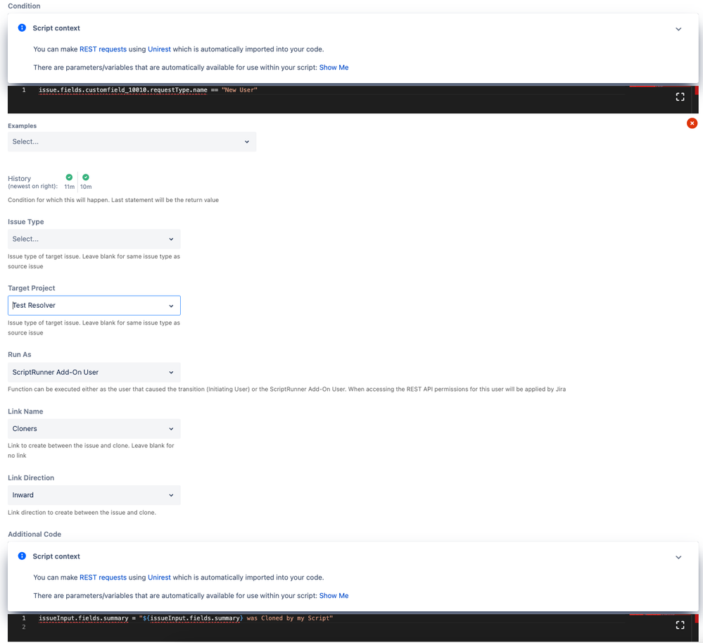

Did a check with my Jira Cloud instance to test the Built-in Clone Issue again. Try using this:
issue.fields.customfield_10010.requestType.name == "New user"

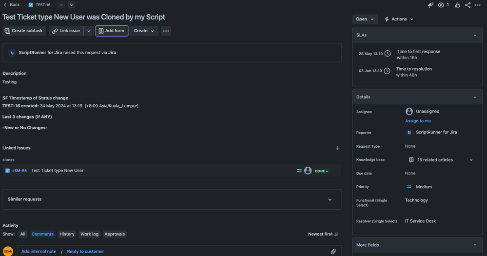

I set mine up as a Post Function when I transition to "Done". It successfully cloned general details within the same project, and then tried it to another JSM project - both works. I would assume that it should work with any other project as well to clone the general default field details. If you need to fill up fields and/or other specific details, you can add the code at the bottom console for "Additional Code".
Here is the workflow set up:
And this is the ticket which was cloned/created in the other project and linked back to original ticket:image.png

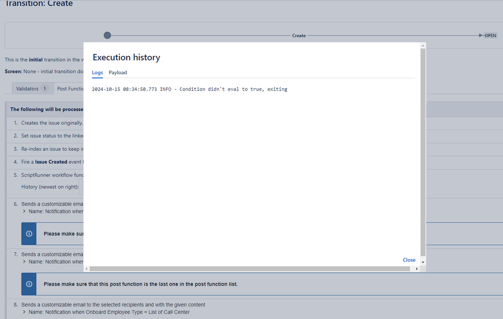

hey @Laura Jimenez Valencia ,
I just did another test, incase there was any changes, and it looks like it still works, when I set the condition with:
issue.fields.customfield_10010.requestType.name == "For Demo General"
I don't think it is a case-sensitive issue, but you could try something like:
issue.fields.customfield_10010.requestType.name.equalsIgnoreCase("for demo general")

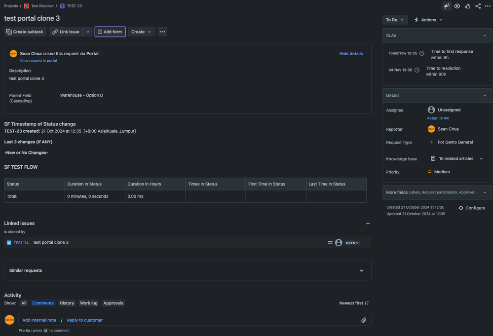

Anyway, I created the ticket directly from portal and had the post-function run:
My views:

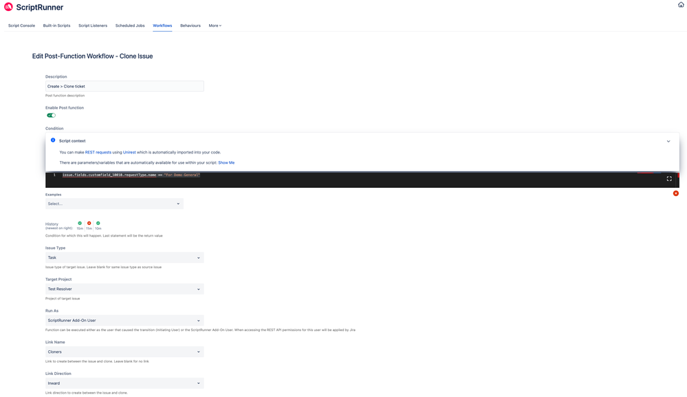

Eg1: ScriptRunner for Jira Cloud's workflow page:

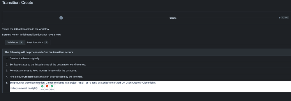

Eg2: Workflow (edit) page, I believe you are trying to do a post-function at portal ticket creation/submit:
If you've tried it all, well, the only other recommendation I have left would be to create a Support Ticket with us and let our support engineers give it a shot.
October 15, 2024

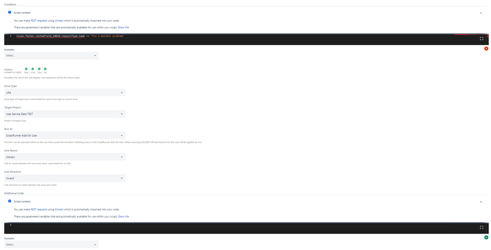

Hi @Sean Chua _Adaptavist_ ,
I have the same problem, and I test your solution and doesn't work. I don't know why. I add screenshots of my test. Can you help me?
Snipaste_2024-10-15_10-40-25.pngSnipaste_2024-10-15_10-41-16.pngSnipaste_2024-10-15_10-41-48.pngSnipaste_2024-10-15_10-43-20.png
