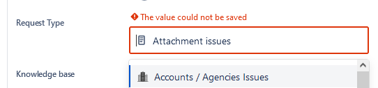

we are running a customer project in which the reporting has a heavy focus on the used request type for the Incident and Service Request issue types. Of course, due to human error, it happens that requests are closed with the wrong request type chosen.
After evaluating to bring in a "supervisor override" to reopen closed tickets for project admins, we found out that it is possible for the issue type "[System] Service Request" to change the request type when closed, but not for "[System] Incident".
I checked the workflow (transitions and statuses) but I cannot see a difference. Also these parts of the workflow havent been changed. Is there a reason why there is a difference between these issue types? Or am I just to blnd to see the difference?
This is the error message that appears for closed Incidents:
Thanks, Stefan

Stefan Schumacher
September 7, 2022
Right, finally got it. [System] Incident had property "jira.issue.editable" set to false.
