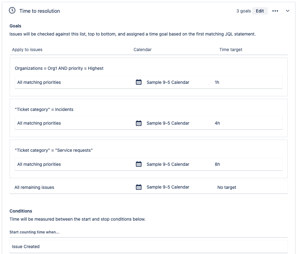

SLAs can only be paused or restarted, you cannot say take remaining time of the SLA and add 30 days when it moves to backlog. You can only set it up so that when it is moved to backlog and it is already started, then you can either pause it, restart it, or have a goal that sets the SLA to something else like my example above.
If you go to Project settings > SLAs and click into an SLA you will see something like this:
The first part is the goals and this controls for what the SLA applies to, which calendar is used, and the target. And below that you have conditions that define when the SLA starts, pauses, completes and restarts.
So in your case you could set a condition that pauses the SLA if it is moved to Backlog. It would then use the remaining time and start the SLA when it is moved out of Backlog. Or you could add a new SLA that starts when issues are moved to Backlog and stops when moving to any other statuses, and the goal would just be All remaining issues with the target of 30 days. You could then use this to do a reminder automation when that SLA is about to breach.
And as I mentioned in my first answer, you could add a new goal/rule to an existing SLA to set the target to 30 days when status = backlog.
But none of these cases would allow you to add on to the existing SLA counter, you can only change the target based on the rule.
