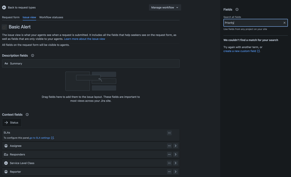

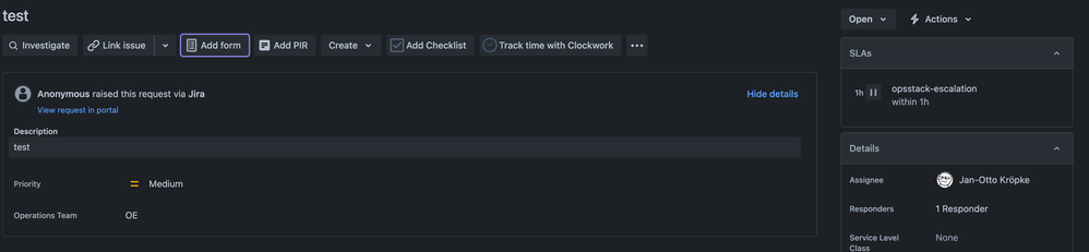

In my case, I want to reorder the Priority and Operation Team field to the right side (to detail)
But on the request type, there is no priority field to re-order.
That is the reason, why I'm asking for help.

@Jan-Otto Kröpke
Unfortunately, there is no way to move the required fields to the context fields section (right side)
Everytime you make the field required (in project Field Configuration or in Request Form tab (in Request type settings), it will become part of the Request Form (left side)
So changing the position of those required fields is only possible within Request Form tab in your request type settings ( in your case; above or below description).
