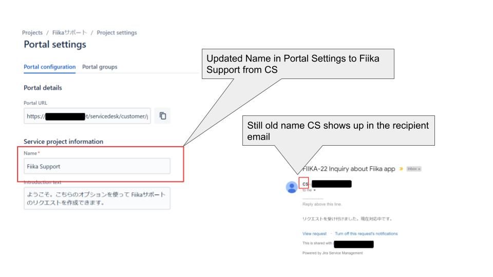

I updated Name in Portal settings to change email sender's name a few weeks ago by following the instruction on this knowledge base article, but my change still has not been reflected on a recepient email. How can I update sender's name in email notifications?

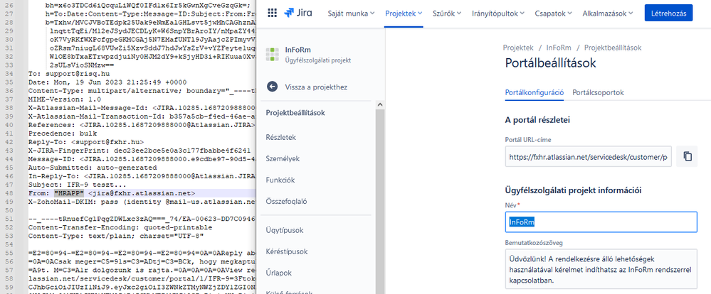

Hy, I face the similar problem. I just tested the behavior with a fully new portal customer mail address - no contact history with Jira Service Managemenet. The portal name was changed yesterday, but the email sender name from the project remain the old. I checked the header, and the received message "From:" contains the old name. Any guess to check?

@Brant Schroedersure, sorry for the delay. I modified the project and portal name from HRAPP to InFoRm. It was successfully modified everywhere, only the sender email name was stucked (sorry for the Hungarian UI, I hope it is understandable for the case):
Originally it was modified last week. On 19th, I updated the portal name to something else, and back again, but the sender name was not affected at all.
