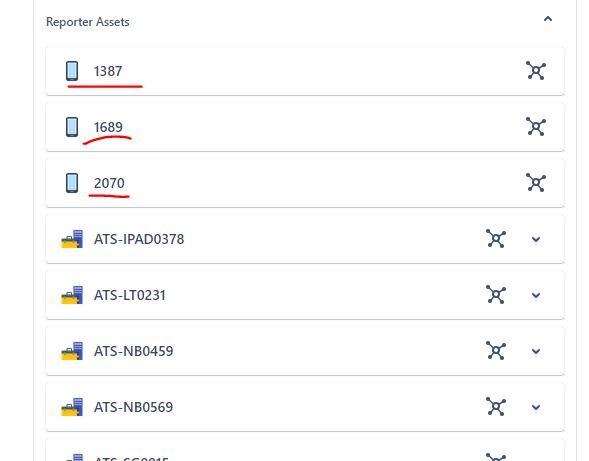

Hi there,
I have a custom field that displays assets assigned to a user.  The field displays the Label from the object type and for the most part that is ok, but there is a particular object type where the Label is an ID and when you see it in a list it makes no sense.
Is there a way to display the item seen on the custom field as something other than the label in this instance?

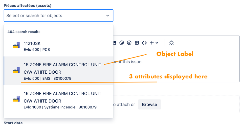

Chu Dam
April 23, 2025
the main object Label will be show in the list, but then when you click on the list and show the listed objects, others choosen attributes appears in the select list normally.

Ryan Didur
November 1, 2024
If you add additional object attributes to the Filter object with attributes they will show up in the selection box. You can change what attribute(s) show. Just add an additional one then remove label.
