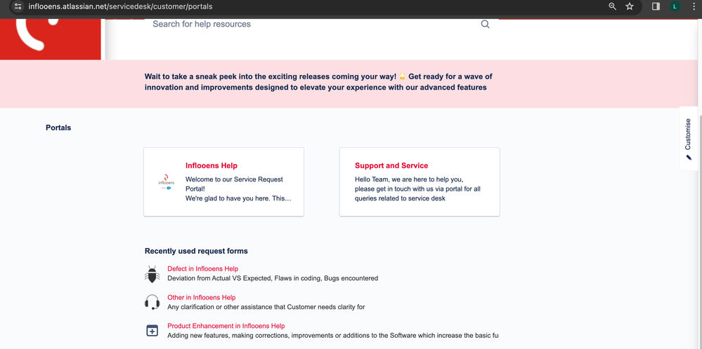

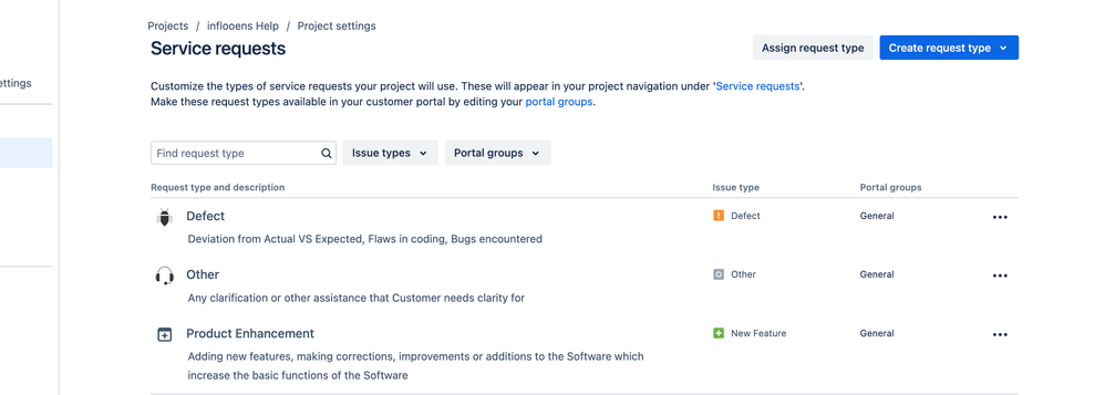

Hi Team,
I would like to change the order of Issue Type projected on Customer Service Portal reflecting on JIRA. Currently the order that I have is 1. Defect 2. Other 3. Product Enhancement but what I need is 1. Product Enhancement 2. Defect 3. Other.
Attached is the snapshot of how it looks like currently.
Any suggestions on urgent basis are highly appreciated.

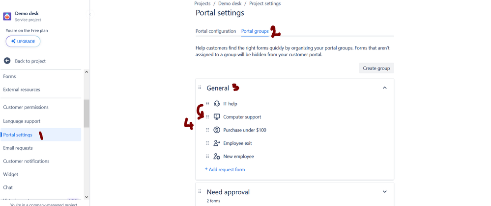

Hi @Lakshmi Kumari
To change the order of the request types in their groups, you can do this by going to the portal settings in the project and then drag & drop the request type to the correct order as shown below: dng.PNG

Hi Riza,
Thank you for the quick response and the detailed steps with highlighted markings.. It worked :-)
Thanks a lot..
