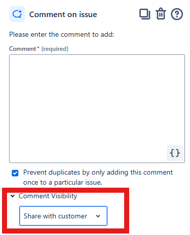

So, I was exploring the ways that I can go through this and set up an automated message. I turned on automation for Jira also and added an action to do a comment when a work item is created, but the automation is doing it internally (adding an internal note), so if anyone has any suggestions on it, it would be much appreciated.

If you go to your automation and go to the action that adds the comment you should be able to update the comment visibility as highlighted below in the screenshot.

I forgot to check this dropdown to update the visibility. I appreciate your help. It worked

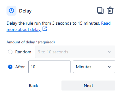

Just one more question that triggered to me: can we set a time, like after that point of time period when a work item is created, automation should run, let's say when a ticket is created, after 10 mins the automation should run, instead of immediate action.

Hey @Shivam Sharma - Optimizory - Yes, you could use the delay action function in automation to wait 10 minutes before it does any actions after that. So for your use case you would want the delay action prior to the add comment action.

Hey @Bryan Trummer - ReleaseTEAM , I really appreciate your efforts, but I'm not able to see this delay action function in the automation.

@Shivam Sharma - Optimizory - Interesting it should just be there as Delay. I did scroll through the automation list to find it, I did not use the search function for Automation.

It is still not visible to me; maybe I'm on the standard plan. That could be the reason of some limited automations and actions

@Shivam Sharma - Optimizory - Yeah its because you are on the standard plan. If you want to have a sort of work around you should be able to use the refetch issue data action. Stack a few of those and it will act like a delay. However, for a ten minute delay you might have to stack quite a few of them.
