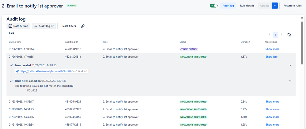

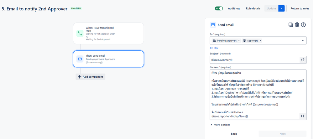

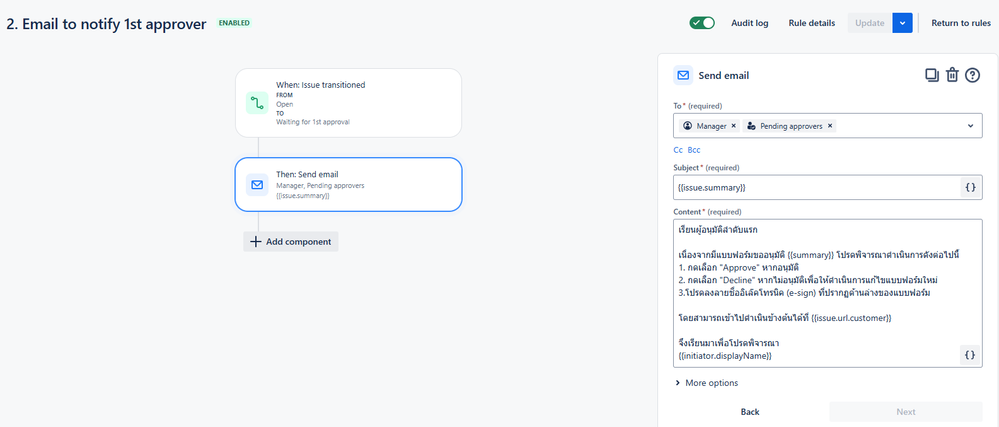

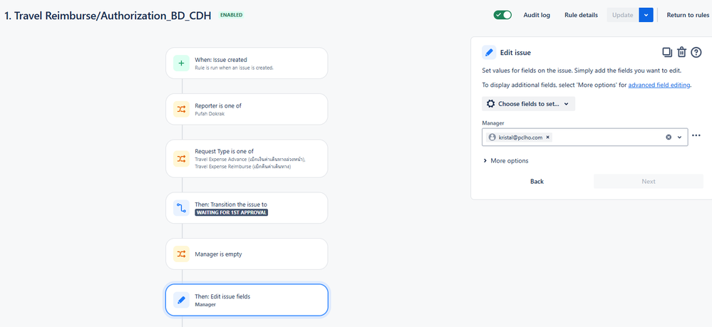

I create automation for two steps of approver 1st automation to transit "open" to 1st approver (manager)" then send email to manager 2nd automation to transit "1st approver to 2nd approver then send email to approver. Unfortunately, email sent to manager and approver unsuccessfully. please give me the advice how to correct it.
Transition to Mgr.pngEmail to notify 1st approver.pngTransition to final approver.pngEmail to notify 2nd approver.pngAudit log.png

@Benjamin
I resolved issue by adding manager's email in each automation and turn out successfully. Thank you for your advice.

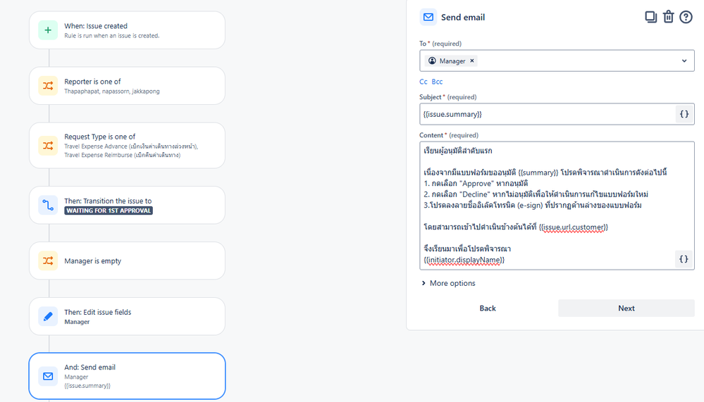

HI @Jedsada Rangsethienchai ,
Would recommend simplifying to just 2 automations. For the 1st approver, just add the email action at the bottom for the Travel reimburse automation instead of having it separately. Same for the 2nd approver.
IT should email once it's combine and the automation is triggered.

Hi @Benjamin
thank you for yourReply from Benjamin.png reply. do you mean like this
Benjamin
January 29, 2025
Yes. Looks good. With this configuration, every time the manager field is edited...it will always be followed by an email.

@Benjamin

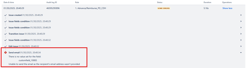

once I tested it. There is error step of sending email as given screenshot.Transition to Mgr (error).png

I retested by adding reporter as recipient. email was successfully sent as given screenshot.  I asked chatGPT and answer given as below which I don't understand.
The error message in the audit log indicates that the automation rule failed to send an email because the recipient's email address was not provided. The specific issue is:
  • The field customfield_10083 (which likely holds the manager’s email address) does not have a value.
  • As a result, the automation rule could not retrieve an email address to send the notification.

Benjamin
January 30, 2025
Since the automation did edit the manager field in the issue, did you notice that the manager field did get populated? If not, then something is not right in setting the field in the automation.
