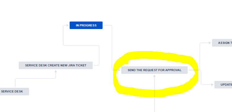

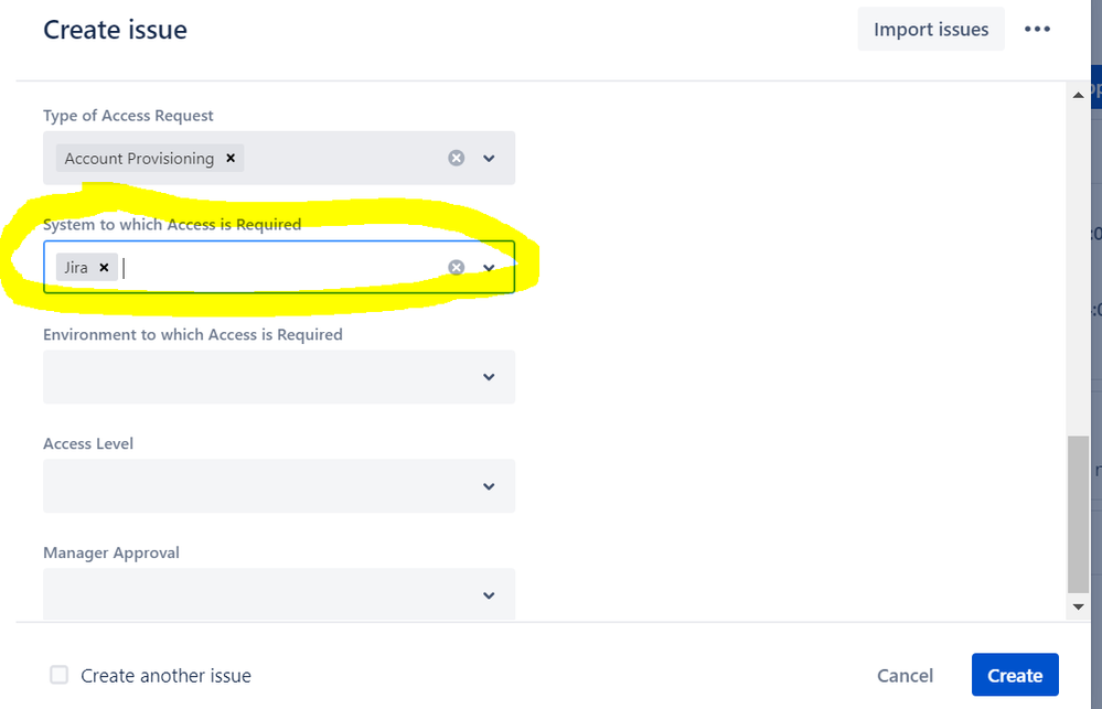

Can someone will help me out which In a Service request form i have field called Access drop down field.
Access---Jira and Database
If i select Jira then 1 approval should be visible for L1 only
If i select Database from drop down then 2 approvals should be triggered which are L1 and L2.

You might be able to accomplish with using different statuses, each with a different number of approvals. You can create an automation rule that fires when the Access field is changed (Field Value Changed trigger), that then transitions the issue to one of the two statuses based on the value of the Access field. Then your Approvals should kick in from there.
