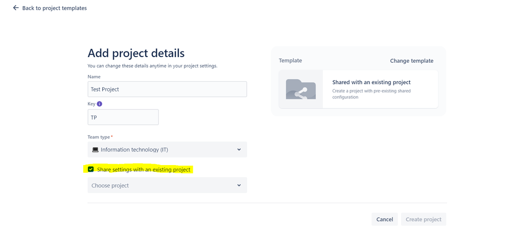

Can some one will help me out what is the main use of "Share Settings with an existing Project"
If i check and create a New project then how it will work?

Hi Sreenadh,
It will create the project using the same Schemes used by the existing project. It other words the two projects will share the Workflow Scheme, Issue Type Scheme, etc.
But it will not create the same project roles or copy the people from the existing project to the new project - basically, just the schemes.

My question is if i create the project by using the "Share Settings with an existing Project" then we can get the configuration changes from one project to another project.
Please help me out is it possible ?

That depends on what you mean by "configuration changes". If you mean that you change the shared scheme on one project will it automatically be changed on the other project? If that's the question, then yes it will.
