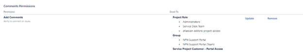

We have two groups of customers, those in leadership roles and those that are independent contributors. When we give these groups comment permission, they can only add internal comments. Is there a way we can give them permission to use the 'reply to customer' comment option?

You could give a group agent access to only use the reply to customer by giving them comment permission. What controls if you can reply to the customer is the JSM license.

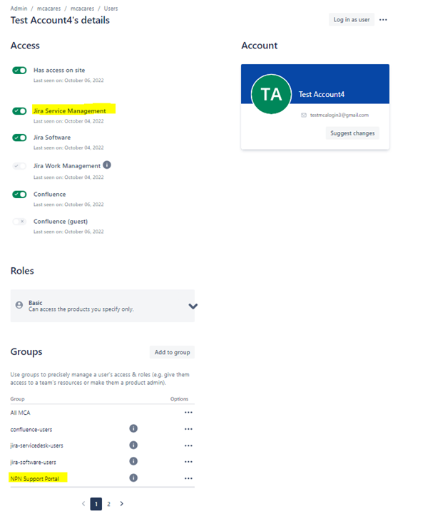

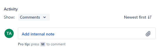

Thank you! I tried this but am still only getting the 'add internal note' option. I really think that I was able to do this before, but now it isn't working. Could there be another permission that is preventing it? I'm at a loss.
The user that you tested this with, are they assigned a JSM license?
The group/role that you gave comment permissions to, did you also give them Service Project Agent permissions?
I did not give the group access to the Service Desk Team role. Is that what you mean?
No, in the permission scheme there is project permission called Service Project Agent, this is what gives you access to interact with the customer, including reply to customer. You would also have to change other permissions so the specific group can only use the reply to customer and not be able to edit the request, change the status and other things.
I added the group to the Service Project Agent permission, but there is still only 'add internal note.'
So you may want to check if the user you are using have been assigned a JSM license or not.
I just did a test in my sandbox and gave the Administrators role only access to browse projects, Service Project Agent, and Add Comments and I was able to still see reply to customer but was not able to do anything else.
I confirmed they are assigned a JSM license. Could you test have worked because it was the Administrators role?
