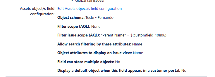

You can do it!

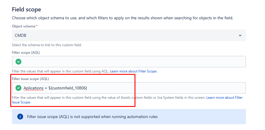

Let's to say you need to have this configuration for your assets field B
"Aplications" is the name of attribute I'm using to make the relationship between the assets objects, then after you just need to change the field ID.
This works for Help Center and internal view.
Let me know if you have questions.

Hi @Fernando EugĂȘnio da Silva thanks for your reply.
In your example, is customfield_10806 used to represent the field for hypothetical "asset field A"?
So it reads:
For asset field B, only show values where the 'Applications' attribute matches the selected value from asset field A
If I understood that correctly, what a wonderful solution thank you

@Eli Devlin
Yeah, you got it! This is exactly the point. The field ID is about customfield Assets A.
Sorry if was not clear :D

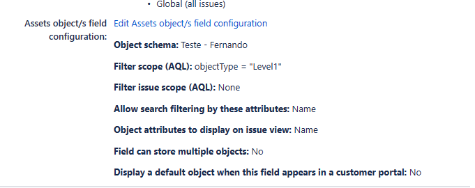

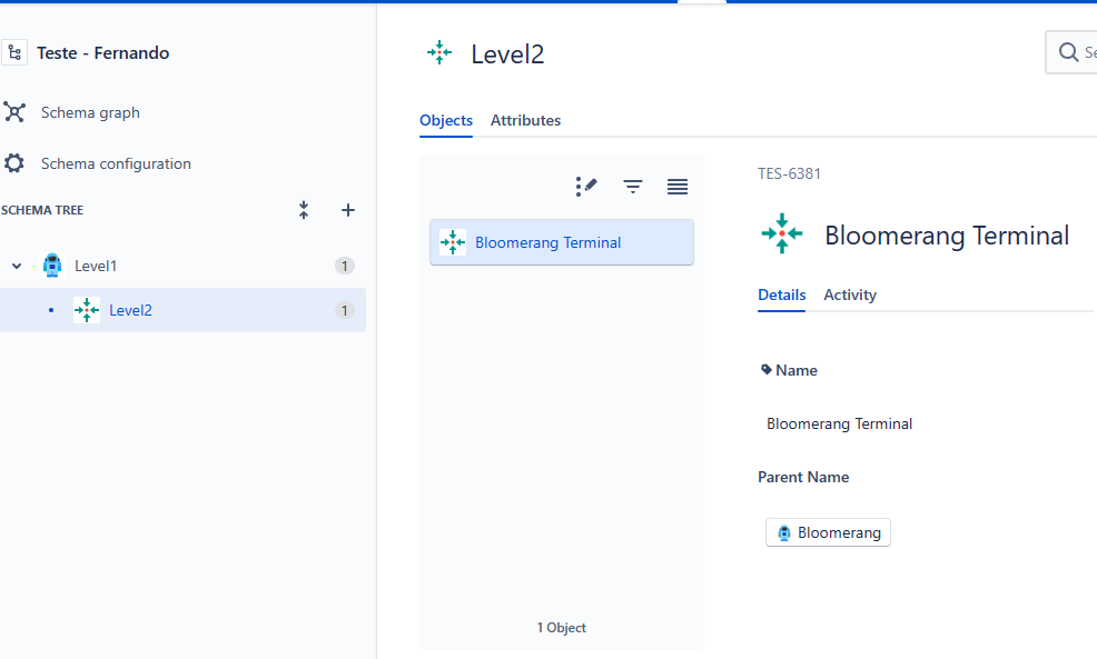

What is your Object Schema Configuration in Assets.
Should be like this:
Screenshot_151.pngFor Level 1 I have all Parent objects and for Level 2 I have all Children objects. Then I apply an Object Reference in Assets.
For my Parent Assets field (Field A) I have this configuration:

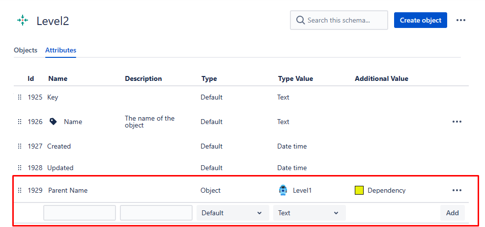

And this is my configuration for Children Assets value (Field B):
Could you confirm if your configuration is like this?

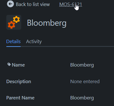

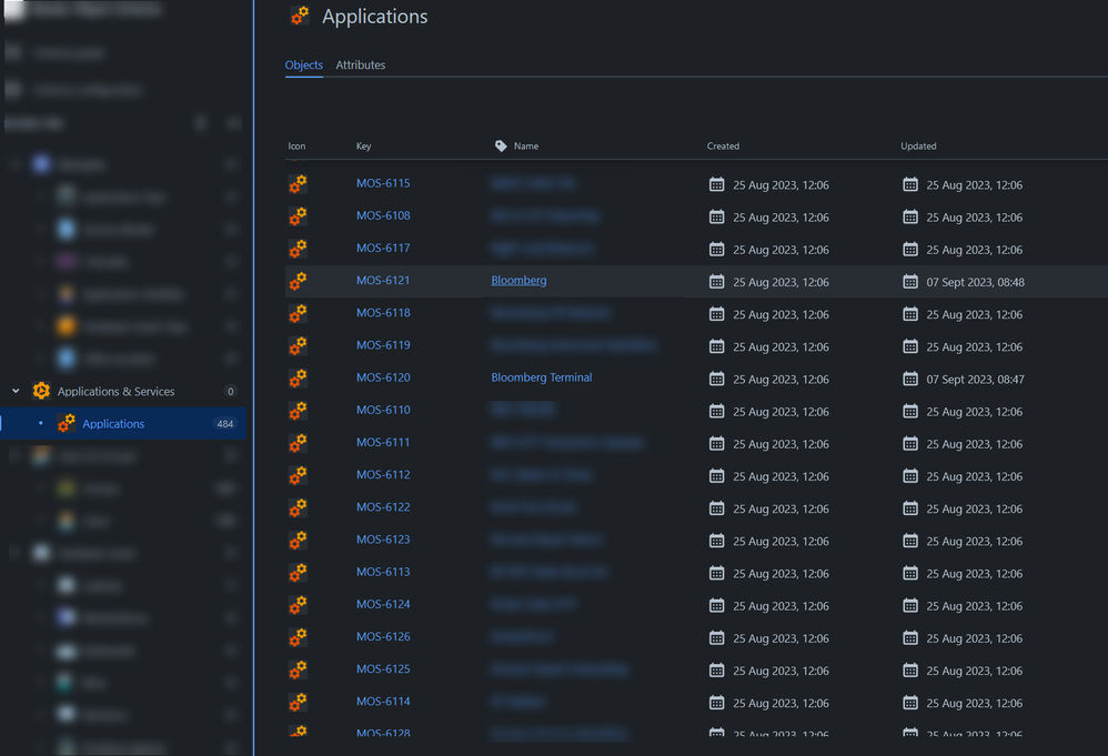

It looks like this, where both Bloomberg and Bloomberg Terminal are the same Object Type (Application) and are not hierarchical in the asset schema:
Here's Bloomberg, the "parent":

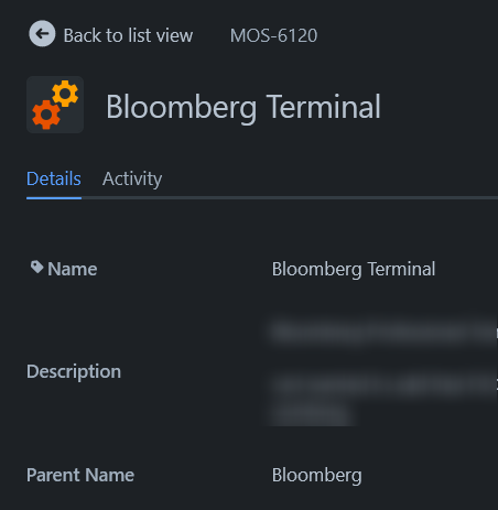

And here's Bloomberg Terminal, the "child":
Writing this out makes me think that they should actually be different object types and be in a true hierarchy, but it may not be required.

Considering your Assets Schema configuration, for your Assets field B you can use this in your Filter Issue Scope (AQL):
objectType = "Applications" AND "Parent Name" = ${customfield_XXXX}
Change XXX for field ID of Assets field A. Just have sure that your attribute are referencing your Object Applications, exactly this:
If you have this attribute type to make reference between your objects, so the configuration will be works fine.
You don't need to use as hierarchy, even being the best way.
